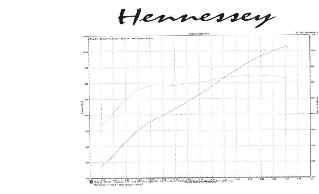

Hi Mullet,
Here is the dyno run on Terry's car right before we took it to the mile.....

Question for the seasoned Milers, looking at the torque curve, if it starts to drop "materially", relatively speaking of course, at 6k rpm, should the shift point be just past 6k instead of closer to 7k?

I think it makes sense to upshift at the 6K revolutions, to keep the torque near its maximum. (looking at Kendall's curve of Apollo's car)

Hi Mullet,
here is mine
looks like at 4250 rpm they are making the same power and Apollo's spikes quicker. I would be curious to see how the spike affects traction in third gear doing freeway pulls or even Mile runs. I know I NEVER get wheelspin in third which might give me an edge if Apoolo's car spins in third on a freeway run. I believe at 4000 rpm he is making a noticable amount more power than the other TT 1000ish hp cars I have seen.
I do like the extra peak torque he is making compared to mine.
At the mile it seems the little extra I have down low pretty my washes out with his quicker spike to peak power.
I'd shift that car at 6500 if it were mine,
When to shift depends on your engine's torque curve and your gear ratios. You want to maximize the torque at the rear wheels. You should shift when the torque to the rear wheels will be greater in the higher gear than staying in the lower gear. The gearbox spacing is not even, so that ideal shift point is different in every gear. Also since you cannot shift in zero time, if you are near the finish line sometimes it is best to leave it in a lower gear than to shift, losing some speed by shifting.
I though torque GETS you going and HP KEEPS you going?
I'd rather shift when the HP starts to drop (looking at my graph I shift right before the fuel cuts).

Keep in mind that these are specific results for a specific system with a custom tune. For this car shifting at 6K may make sense. For your car perhaps not. When you make that 7K shift in 4th to 5th you are putting yourself at a better RPM starting point for 5th. I will be writing it up later once I get the full results to post from our day with pics and vids, but I did two separate things on my best runs. (231.5 and 231.1) On one I shifted to 6th early and in one I stayed in 5th till the end. Staying in 5th till the end I hit the rev limiter shortly before the finish line and it cost me a couple mph. In 6th for my car anyway in depended on when I got in it. 6th would still pull and I have a good vid from my second best run that will help you see that. (I did not have vid from my best run.....my camera hates me :ack :lol)
The best pulley/tune run of the day on a 91 Heffner tune was a 205.8 and he went to the rev limiter everytime. I think for the pulley cars getting into 5th from a 7K shift is the best plan, but I could be wrong. I am pretty sure when Mullet did his 195.5 on a pulley in Texas he went to the limiter. Stunts on Sunday did a 188.7 for his best run by leaving it in 4th till the rev limiter. On Saturday he posted a best of 202.8 shifting that way as well. It really depends on your specific car. Maybe a dyno run would be in order to see what you are really getting. :cheers
