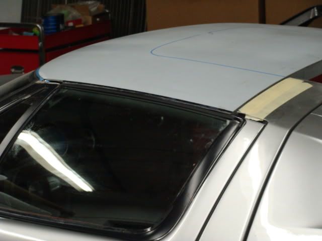

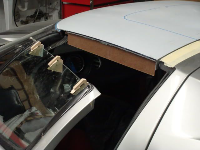

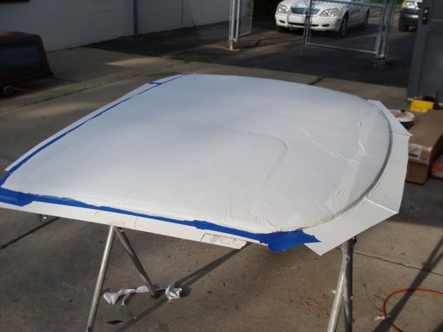

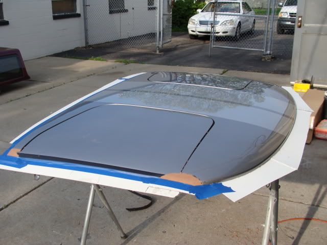

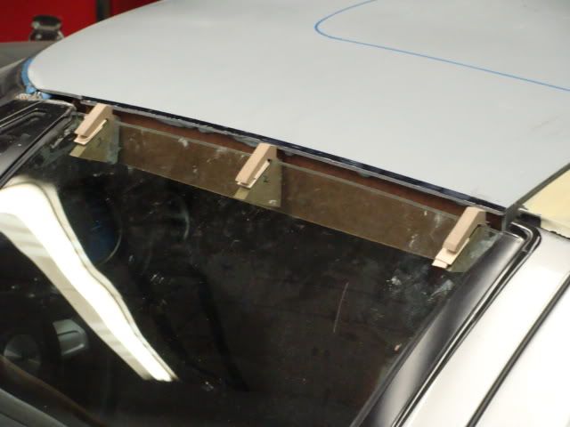

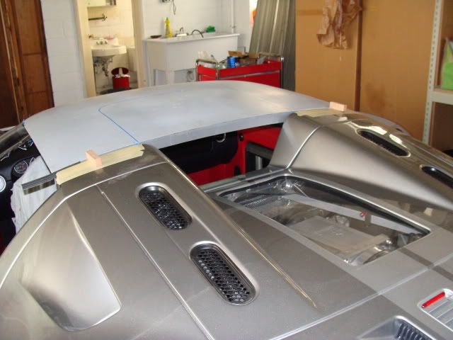

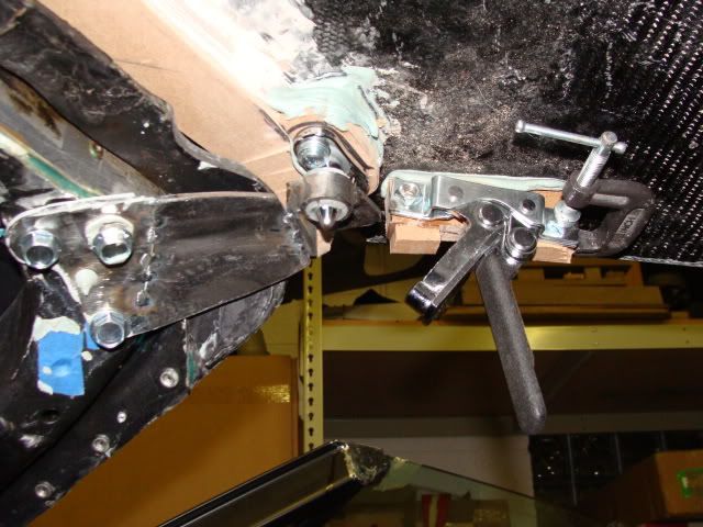

GTX1 surgery
So are we talking about cutting the top of the doors and then a way be engineered to attached top to the existing opening of the car? Why cut up the existing frame? I want that Smoky and the Bandit T-top in my GT :banana
By cutting the top of the door away from the a and b pillar, you'd get the T-top effect, and the benefit of "normal doors". If you didn't cut the frame, you'd still have the restricted entry-egress of the regular GT door. Also - if you didn't cut the door frame, the resultant day light opening would be a lot smaller.

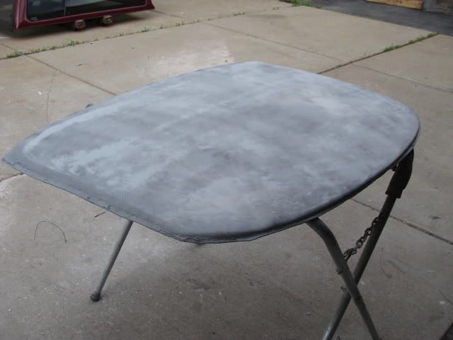

GTX1 surgery
Hey Kip,
Sounds interesting, looks great. Are you doing it in all CF? You say someone is making progress on a soft top too?
The roof will be made from carbon fiber to save weight and be stiff. We can paint and stripe them to match or leave bare carbon.
Yes - Steve Hemstock was working on a soft top. Not sure how it is going.

Most outstanding solution to the rear window issue.:thumbsup
Kip,
Have you considered adding Gurney bubbles to the roof also?
