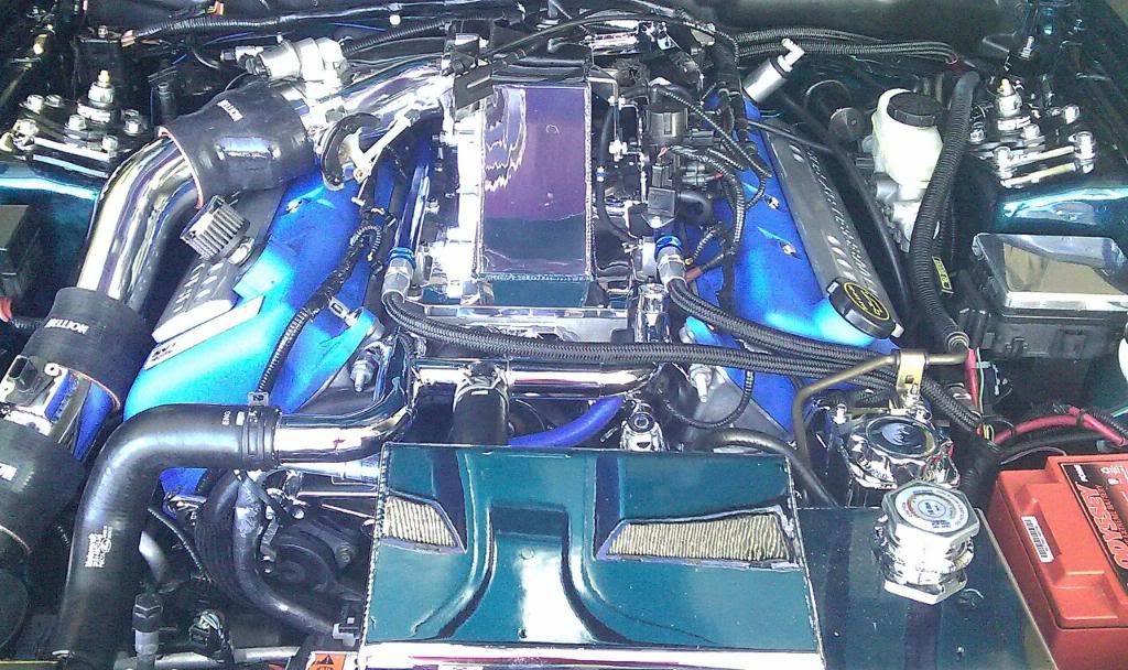

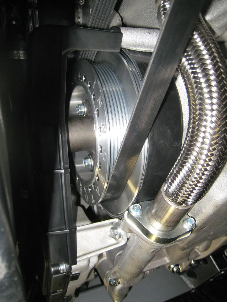

OK finally got the balance on .I would never recommend installing the balancer to somebody that does not have experence.There is alot of cleanig up around the Dry sump oil pump and casting on the timing cover .You have to grind down the TDC marks ,Where the plastic cover bolts down for the oil pump belt drive on the timing cover ,oil feed hose and housing and the casting on the timing cover where the crank sensor bolts to .All of this is not visible when the dampner is on and can look clean just depending on who is doing it .Once you have the Dampner on i would change the blower pulley since you have total access to the tensioner .With the IW 10% and a 2.80 the stock belt works but its a tight fit .The stock damner weighs 21lbs and the IW weighs 11lb

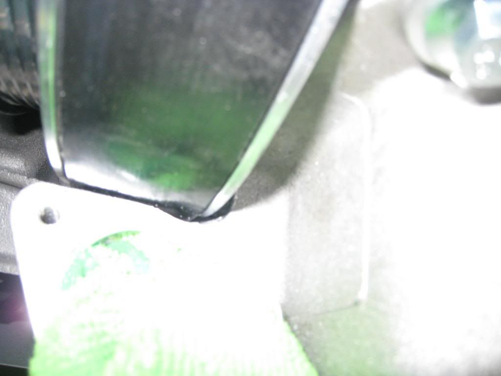

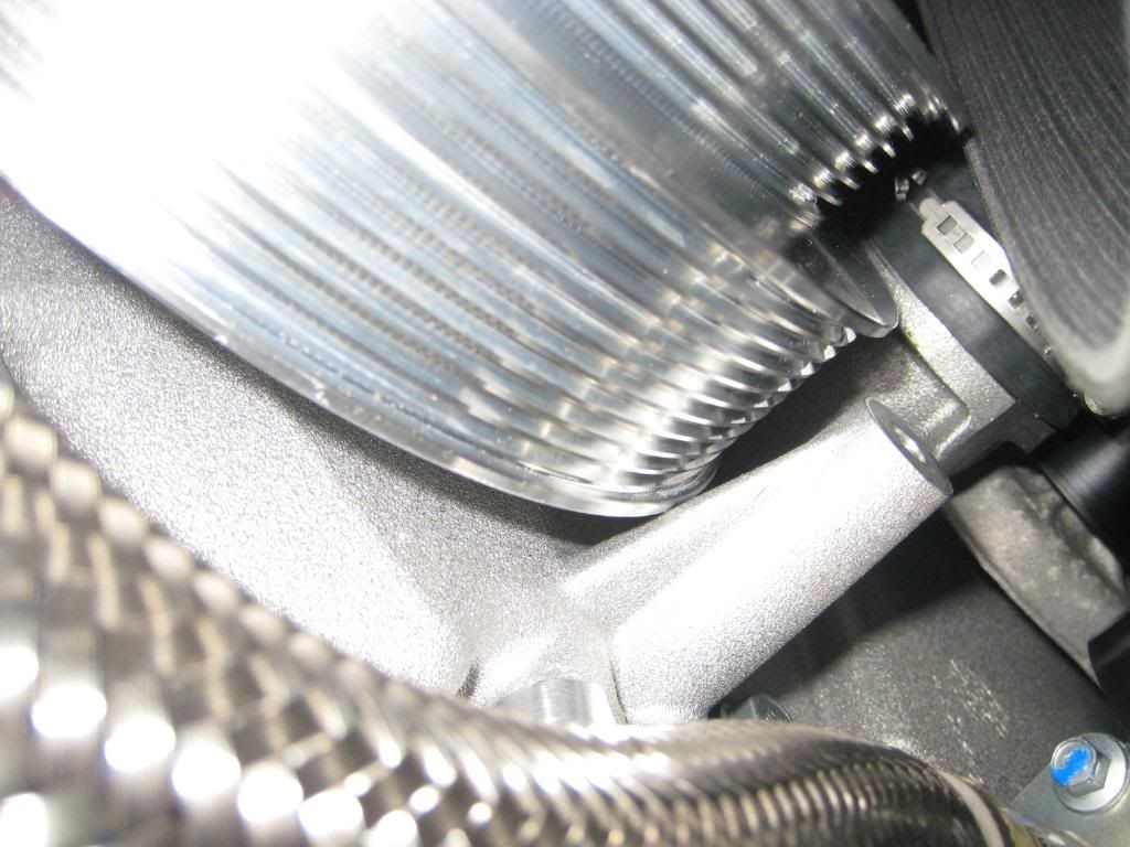

This is on the bottom by the braided oil feed line .I would leave enough room to slip the belt off n on without having to remove the dampner
Cleaning the fitting on the braided line to clear from hitting the belt
Make sure to silicone the bolt as Ford did ,Dont want a leak
After everything its just up to you and what you expect out of your GT .Believe me ,10lbs of rotating mass is going to help all around .NO matter what you do 1/4 ,roadcross or even street race its going to make a difference .I modify my 190 mile GT cuz i have friends that have modified ZR1 and TT Garllados and my GT is going to live up to its name .If you want something that simply bolts on get the IW dampner without the 10% or even the ATI dampner ,its not billet but way lighter ,im going to dyno the car this week i will let you know what it pulls .
