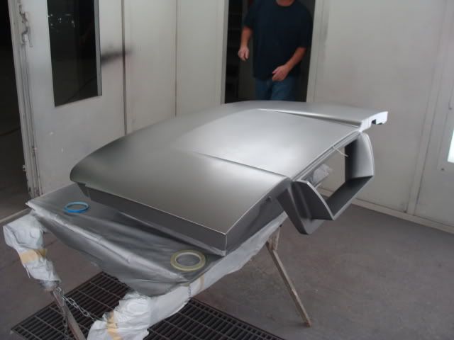

After the window frame was bonded in, the next step is paint.
Normally, this would be pretty straight forward.......................................
However; this was a custom color.
I went into the booth after the base was sprayed and about freaked out.
It was green....
We'll, at least a very green shade of silver!
The paint store I have used exclusively for over 8 years totally botched the color match and the color they gave me for the stripes was the same color as the body....... Then they didn't want to re-mix it that day.
Not good. Depending on how they handle this, I'll be choosing a new shop for paint.
Panic time.
After another round of mis-matched color and another panic, the second paint source stayed late and got a perfect match. Perfect color, perfect metalic, right on! If you need paint in the Detroit area, go to GNE in Hazel Park and ask for Rob. These guys will probably be getting my account.
So here we go, into the booth.
With urethane paint systems, the color goes on flat, and it looks pretty splotchey. The magic happens when you put on the clear.

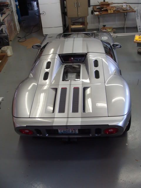

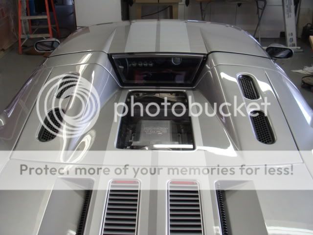

So, this is what we ended up with;
It really turned out pretty cool and I am really, really proud of what my crew has been able to execute on this one.
We need to finish the molded details on the ends of the seals, so the car will be coming back after the Rally.
I really want to thank the owner for asking me to do this.
It has been a remarkable project; technically and creatively.
It's also been a great chance to get a functional roof on the GTX1 that is really integrated with the car's appearance.
