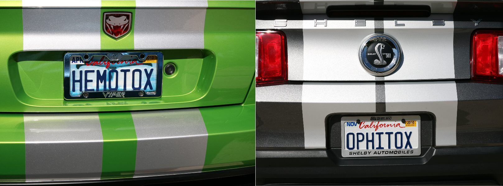

Midnite Blu
Got you on that one. If you can figure out the meaning of the "Toxin Girls" license plates in this image, the first drink at the Cahuilla Creek Casino is on me for the next Bony Memorial Run
