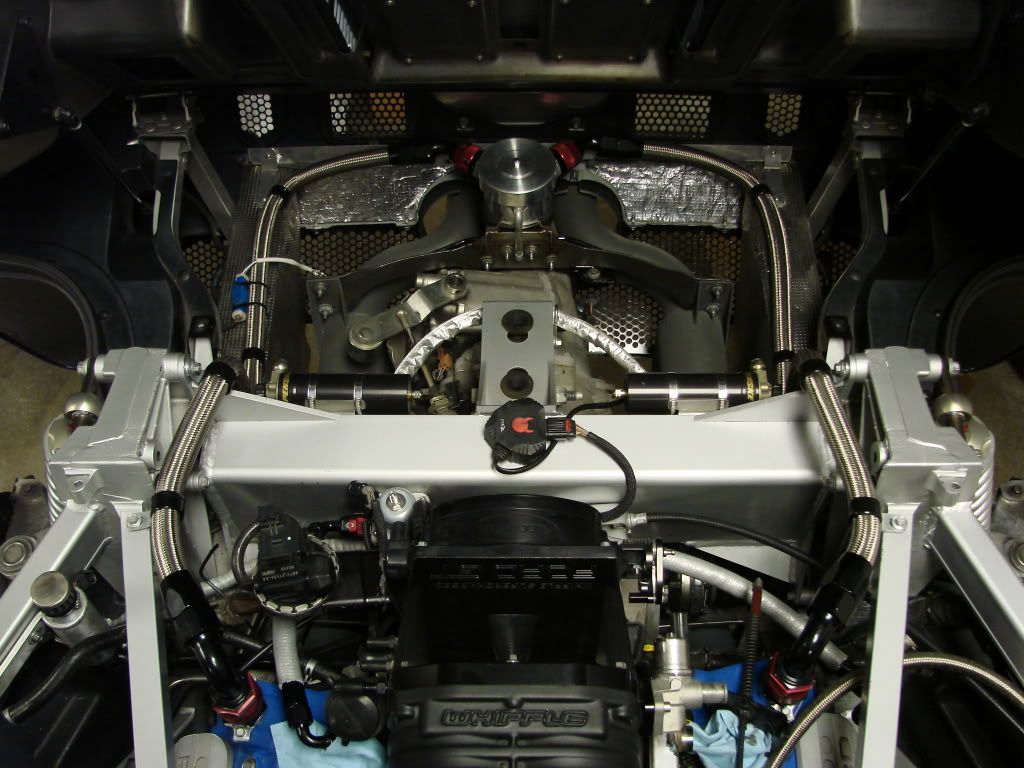

Morning Guys,
This is what we did on Mark’s (FUBAR) car.
http://www.fordgtforum.com/forums/s...ystem-(lots-of-pix-not-dialup-friendly)/page3
Page 3 and 4 I believe have the images of the breather system I developed. Because of the large fittings and hoses, the blow by air velocity is much lower than when using the stock breathers, because of this it carries much less oil and therefore not much makes it to the actual breather canister other than air and some water vapor. Other benefit is that it relieves more crank case pressure for the higher horsepower vehicles.
The tank can be mounted other areas in the car if desired. They’re also available in anodized, what ever color you desire, hard black for instance.
Cheers

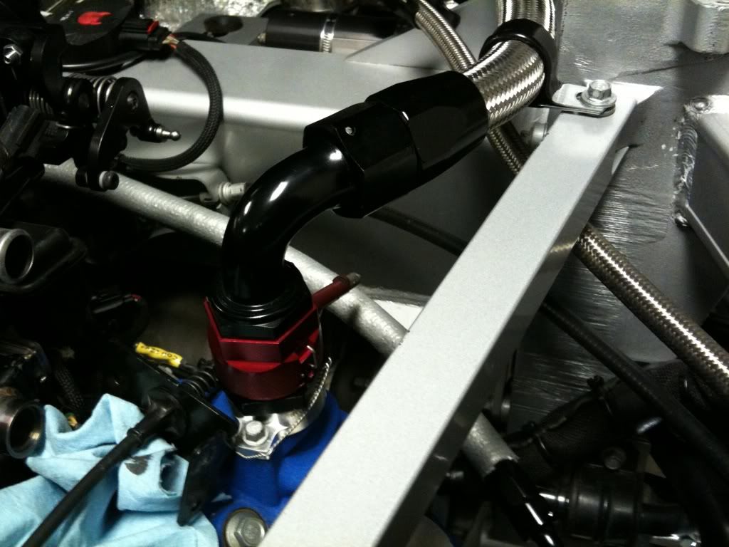

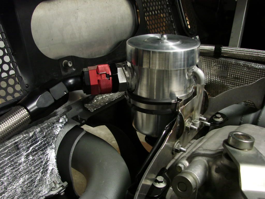

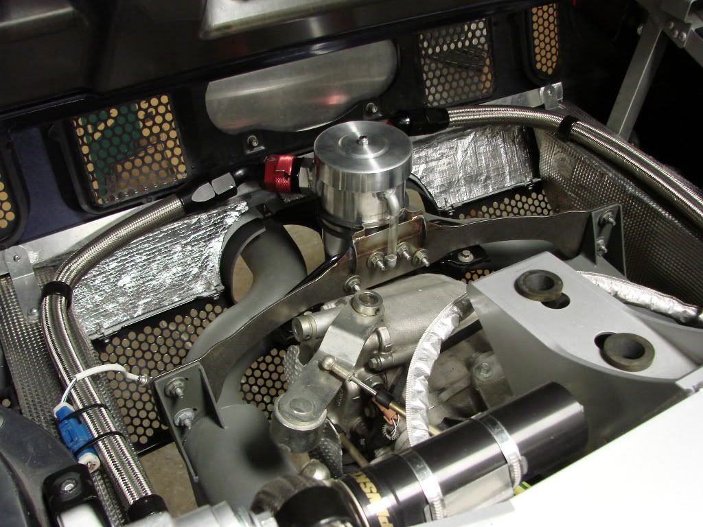

Hi Guys,
I think this is really simple... most of the GTs that are modified are making pretty good power (900-1000hp at the crank). They are either supercharged or blower mods, or both. The two section oil scavenge pump can't keep up with the blow by (air pushed past the rings on compression and the power stroke when the motor is under boost). This excess air builds up in the crankcase as a positive pressure. The negative pressures (sucking) that are before the compressor (especially on a blower car), help the positive pressures in the block push oil through the stock PVC breather ports. These PVC breather ports, because of emissions laws, are routed back into the intake since the air they emit contain oil.
Oil, through our intake tract, is bad for our motors to consume. The oil fouls our plugs and o2 sensors... worse yet Oil has a lower flash point than gasoline... because of this, sucking oil into the intake or into the combustion chamber, can and does often lead to detonation under power. Detonation destroys engines.
Best advice I can provide and those that have done similar mods can provide, is to remove your PVCs and vent them into a separate catch tank that doesn't connect to your intake tract.
I personally recommend larger lines -12 at the absolute min and preferably -16 lines. The reason being that the smaller the hose, the higher the airflow through them and the more oil the air will carry... verse a large line with much lower air velocity and therefore much less likely to carry oil out of the motor.
A few examples of the pieces I built for Mark’s GT
Cheers
4,196

I have seen Evan's oil separator and if it was 2004, I'm sure Ford would be using this on all the cars. It looks OEM and if you wanted to take it off for some reason, there are no extra holes, or proof that it was ever used. It's an awesome 1 off American made piece, not a relabeled mass produced China piece.

Now that Lorenzo has successfully brought this thread back from the dead, has anyone used the Guyett Performance separator shown in post #24?
:lol
I have one and like it because it looks the most OEM of anything I have seen. That matters when I get my bi-annual smog test, not having to remove a system that it obviously an add on.
Also Evan gives GREAT product support and service!
p.s. I know Ed Sims and GTED also have one.
