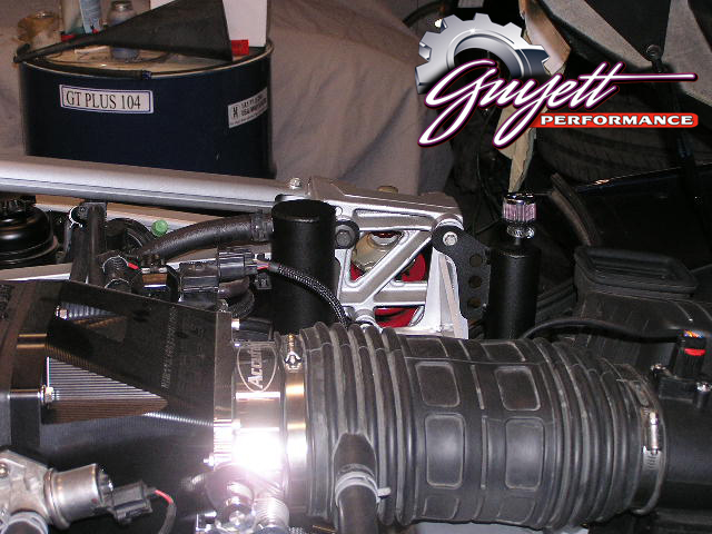

During my 4.0L Whipple install recently I was discussing the viability of adding an Air/Oil separator on the PCV line since I have seen and heard about how much oil is in the intake of these motors when you remove the supercharger. With the increased boost levels we see it becomes much more important; reducing the oil in the combustion chamber and lowering the effective octane rating of the fuel and keeping an oily film off intercooler core thus reducing it’s ability to transfer heat among other reasons. Evan Guyett told me that they were working on a design for this and getting close to finishing a version just for the FGT along with an complementary breather tank for the transaxle. We agreed that my car would get both during the install of the Whipple S/C. Evan installed the two tanks and they look as if they came OE on the car, just as he said they would. He said the Air/Oil separator has three different separating circuits in the unit along with a safety bypass should the unit become completely full. They even put a sight glass in the reservoir like the other reservoirs in the engine compartment. This is definitely a must-do in my opinion.
Photos please.

We have a design in the works and have a prototype nearly done. Definitely plan to debut it at the Rally in August if not sooner. It will be custom kit for the GT with everything needed. The catch can component is, in our opinion, the best on the market and we've looked at a lot.

The Air/Oil separator I prototyped on Bruce's car was developed over months of working closely with one of the top oil system manufacturers on the market who make the majority of the oil system components for the NHRA Top Fuel, Funny Car, Pro Stock, and Pro-Mod guys as well as many of the World of Outlaws and road race teams. Ever since the first time I removed an FGT supercharger I noticed the excess amount of oil in the intake and coating the rotors on the supercharger. I originally looked at what was available, but after looking closely at the current designs out there, I started with a clean sheet of paper and made my own. First and foremost I wanted the function to be flawless with enough thru-flow to as not create any seal and gasket sealing issues under extreme crankcase pressure (a problem many of the Hi-HP turbo diesel crowd has faced for years) and Secondly, I wanted it to fit and look absolutely like it was OE on the car. Where this one differs is in the internal construction, and without giving too much away, I can say that it utilizes no less than three separation stages as well as a by-pass should the reservoir become completely full (highly unlikely due to the OE sight glass). We built the separator to bolt on in just minutes using existing bolt holes already in the chassis and without any modification to even the OEM PCV hose. I also built a matching breather tank for the transaxle that also bolts on and finished them both in the OEM Mini-Tex finish to match the other underhood reservoirs. Here's a pic on Bruce's car:
I'm currently in production making a few of these thanks to Bruce showing them off.

I also just finished a version for the GTX1, which is slightly different in mounting.

That prototype looks amazing.
JLT Performance makes a really nice billet one for the GT500.
http://jlttruecoldair.com/ZenCart/index.php?main_page=product_info&cPath=266_269&products_id=317
The glass versions seem out of place in the engine compartment.
I always wondered why the GT SC does not have an oil separator.
Please post more pics and feedback.

I will have some additional photos by next week when I get a run of both parts done.
