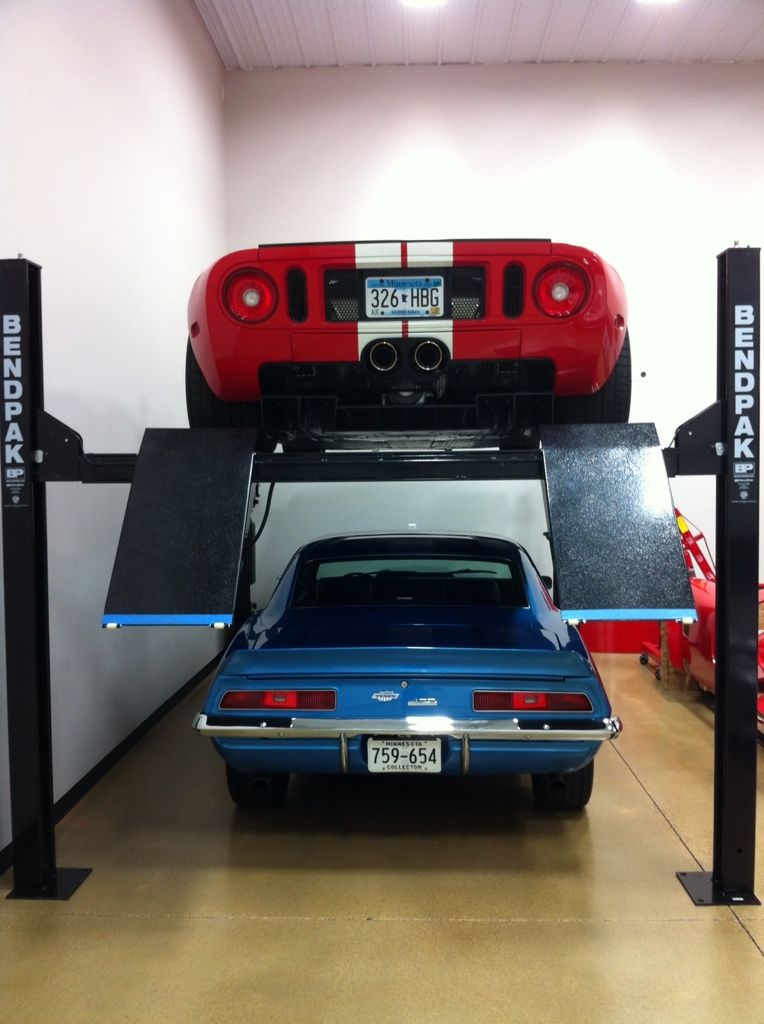

According to the specs for most 4-post lifts, they don't go high enough for a GT parked underneath to fully raise the clamshell. Anybody know differently? edit-- maybe I misread the specs, looks like the clamshell needs abt 75".
I have a Bendpak HD-9XW (extra long, wide version, extra high). 82" clearance. (not all the way up in pic)
HIRISC, you know you can have those ramps fixed and they don't drop.......
Yes, but no need to at the shop.. 18' high ceiling - plenty to allow clearance for the bottom car :)
