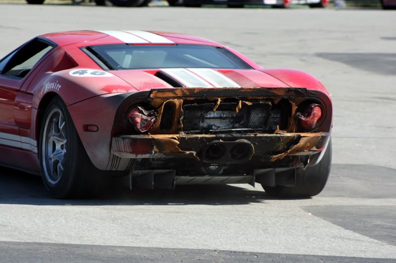

Anyone know anything about this car? Red GT with flames @ Buttonwillow?

It depends...I don't know if there is a difference in the muffler we have and the one the europe cars have but I know of one that got burned a little by the muffler over there...so it can happen. That car looks like the hot dog cooker that just lit it up...I say he isn't running the stock muffler but that picture sure does look like he is...Does anyone know the car?
Of the 101 cars officially imported into Europe by Ford only the twenty-eight sold in the UK have the stock muffler. The stock muffler was too noisy to pass standards in the other countries and were replaced with another after-market product. The car you mention in your post is a German car and did not have the stock muffler.

Hot Damn! GT on fire at Buttonwillow
Hey - I'm taking my GT to Buttonwillow (near Bakersfield, CA) for an open track on Saturday June 23. I hope it doesn't get that hot! Whoa!
A fire suppression system wouldn't have helped that poor GT owner. At least he has some cool photos of it! I wonder how far he went before a corner worker found his black flag! Holy shit Batman.
Time for a bumper delete on that car and a little detailing work. It is only cosmetic damage. I bet the car still runs fine.
It seems that the fire originated from the exhaust pipes igniting the bumper. What cause flames out the back of the exhaust? Excess fuel, a super rich mixture? Can't a tune stop this from happening? It seem to happen when cars lift the throttle and not at WOT. Does it only happen to cars without cats?

Jack Roush had a Gulf car in his Museum with the same rear fate. A/F tune was the reason. Beating on it at the track the tune had fuel build up in muff and then when de-accelarating the car goes lean and the oxegen allows it to ingnite and poof. But this is true with any car watch a NACAR race when they go into the turns the unburnt fuel in the muff lights up and when on the throttle it blows out. A good tuner should take this into account when doing the tune.

OK Guys, I'll let the cat outta the bag. It's my buddy w/ the firey hot GT. So Cal guy w/ heaps of racing experience and just on the GT..... 10,000+ miles of track time alone. Everything is STOCK on this car. His Camber and toe in/out have been played with, but that's it. He told me about this over the weekend and wanted me to ask some questions. I agree the muffler gets HOT!!! I think he's getting it covered. More info later

I met the owner/driver of the red GT that was on fire. I drove my GT at Buttonwillow Raceway near Bakersfield, CA yesterday. He was driving his Viper since the GT is at a dealership waiting to be repaired. He reports it was a malfunctioning injector that allowed excess fuel into the engine & exhaust which ignited the black plastic exhaust shroud of the bumper. His engine & exhaust were stock. $20K damage!

I was at the track with ED. The owner said he did not know he was on fire. A corner worker flagged him down. Had he know it may have been contained a corner earlier.
The fuel did NOT spill in the engine bay. The injector hung up dumping excess fuel into the cylinder. He said it started to run kinda funny, but he was not sure if it was heat soak or something wrong. When that happen he was taking it easy and planning to come in to check it out.
The fuel got lit up in the cat and it spewed both flames and raw fuel out. The raw fuel soaked the bumper surround. And then it was just combustion taking over.
So in this case I think the outcome would have been the same in a cats vs. no cats contest.
I doubt the fire suppression system would have done much good in preventing this freak occurance ( but any fire is a freak occurance). If it had got any worse and worked it's way cab forward then it would have likely helped a bunch.

BTW ...Ed had no flames shooting anywhere. I followed him for about an hour off and on. The car looked like it ran great to me. He has cats and IDA. His exhaust was never black or even noticable.

If I was going to run at a track I think I'd make two 90 degree down turn tips to blow the exhaust down into the airstream under the car. There seems to be a back draft the blows exhaust crud on the back of my car so flames would probably get blown back against the car too. The pictures of the wind tunnel tests show a pretty clear stream under the car and out the diffuser. The tail turn up on the deck is probably making the back draft roll on the rear. :cheers
