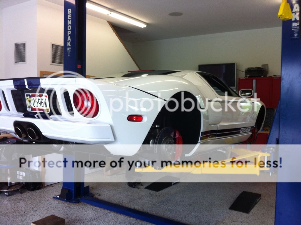

What a day! Tried to change my tires on the car to the new Michelin PSSs. What a cluster. First my car is too low at stock height to get my lift arms underneath. No problem I will make ramps. Then I get the car high enough to find out my lift arms are too short to reach all 4 lift points on the car. I also discovered how skinny you need to be to get in and out of a FGT between a 2 post lift. Not funny.
I then realized it would be easier to just drop the car off at the installer and let them deal with it. This is followed by first a trip the tire installer with the tires in my pickup and then a second trip with the car. That will be followed by a third trip to get the original tires back just in case.
Well the installer didn't have a lift that would work and wanted me to take the car 10 miles away to their other shop with a drive over zero height in floor lift. At least they offered to bring the tires for me. After another 2 hour wait they were on.
This leaves me with the issue of having 5 cars getting worked on at my shop without a functioning lift. I have a call out to Bendpak to send me longer reaching arms. I only need about 4-5". What a day sitting around wasting time.

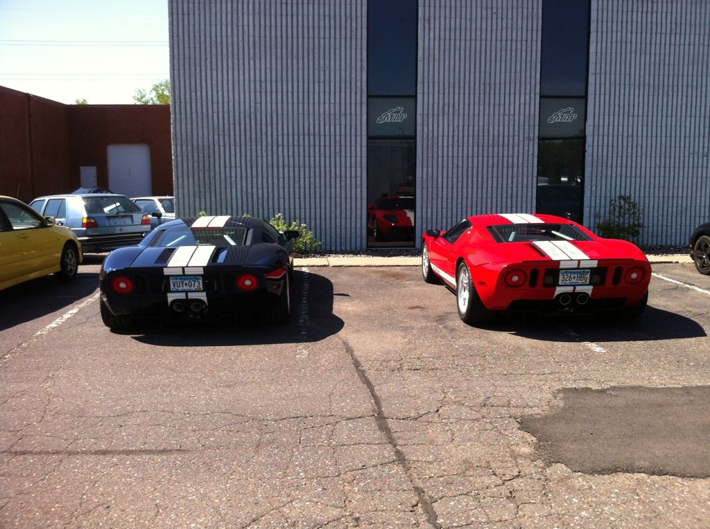

Rob's blue car and mine:
