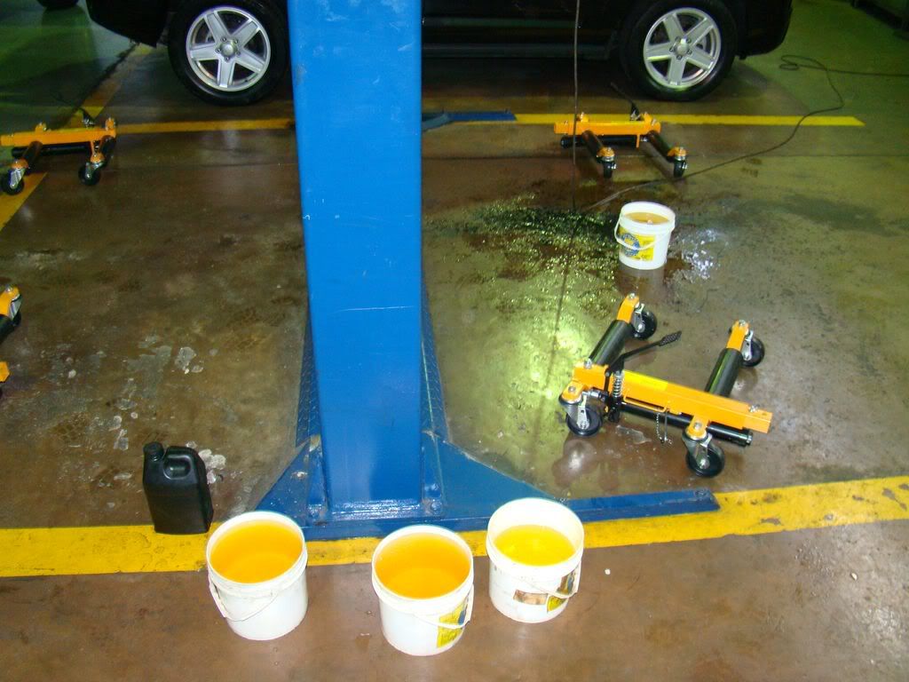

Thanks for the tips and help all you. We finally managed to bleed the coolant system sucesfully. The only left work to do is change the transaxle oil and S/C oil. All these fluids were factory filled and been like 6 years since and only 900k miles on the clock.
The transaxle seems to have a very small leak...here are few photos.

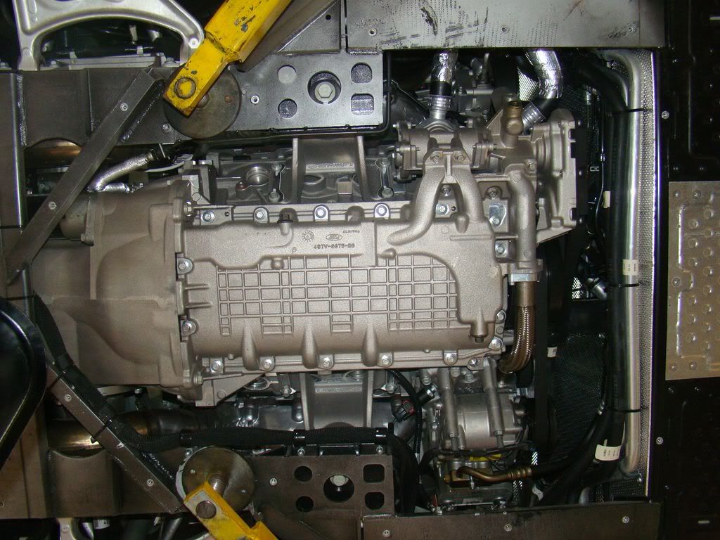

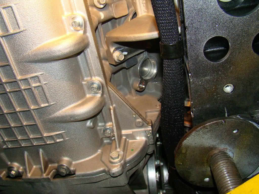

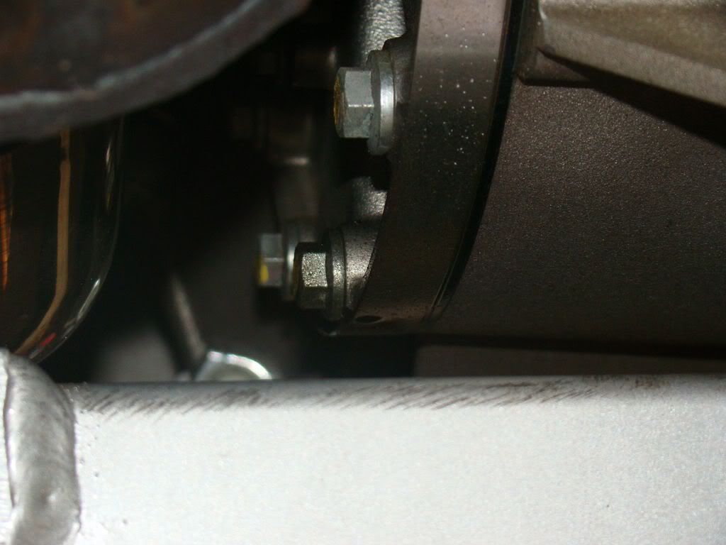

We did remove the hex nuts in the block, both sides, to empty the old coolant as well.
Transaxle small leak.
All the coolant from engine and intercooler plus a bit more that was taken off from the hoses and radiator by pressurizing the systema a bit.
-Diego
4,216
Great pics.
There is no need to change the SC fluid. Up to you if you want to. If so, I would recommend sucking it out. From empt to full, it will take about 1.8 of those bottles. Again, I don't think there's a need.
Regarding the tranasaxle "leak" - I doubt it. It is very common for non-cooler equipped cars to collect some fluid at the bottom of the transaxle. The transaxle does a good job of superheating the oil so that you get a foggy mix from the vent (top passenger side of transaxle) and then the oil collects and runs down the side of the transaxle. Some owners have elected to put a vent breather which address the symptom while other owners have elected to address the problem - and have installed a transaxle cooler. Some owners have done both but our experience is that the breather is not necessary when the cooler is installed.

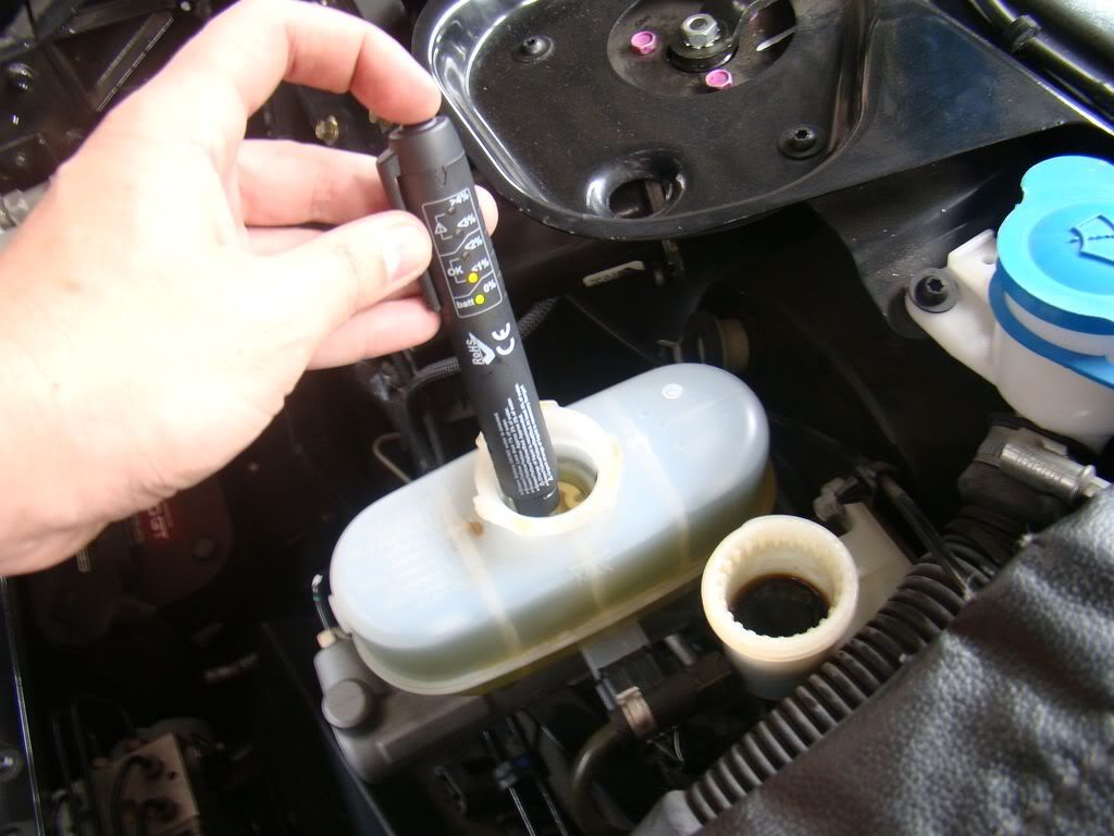

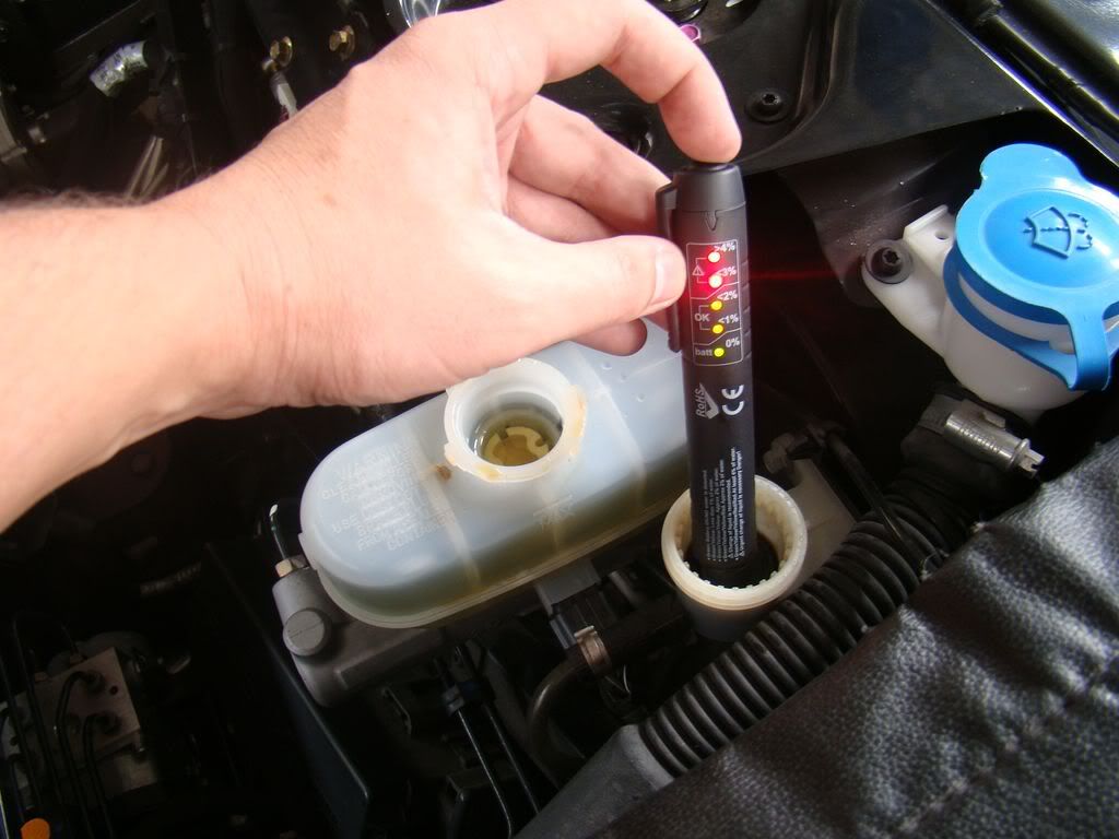

man That clutch fluid looked horrible.. It started out as clear fluid,, A moisture check would have been a moot point. :biggrin

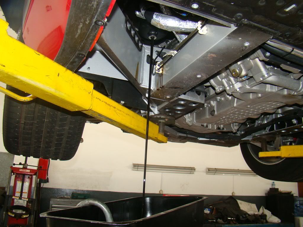

So I got the car at the shopp to change the transaxle fluid that I finally sourced thanks to a member of here that directed me to a vendor who supply the right fluid. WHile we were draining the fluid, I found bit of (not so "bit") dirty/debris of the oil drain plug seal stuff I guess or the seal used to assamble the gearbox housing? But mostly the aluminum particles which surprise me that with only 1k miles on the clock we cand find this...opinions/suggestions?
Thanks for looking.
Sure there is more of this debrisalu. particles in the remaining oil inside the transaxle/drain can we used.
7,554
Most of what I can see is not unusual. I am sure Kendal will comment later. He's drained more tran-axles than I. As you know the particles stuck to the magnets contain iron and will be there from normal gear wear. I have seen some iron chucks stuck to the magnet maybe created from a missed shift / gear grind.
Some of the aluminum would be from the original milling , machining and drilling that didn't get flushed out or blown out before assembly.
As far as the seal material. it could be from a number of places . Has the car ever had a tranny cooler? There are seals at the out put shafts. Small O-ring at the speed sensor. There are three taps on top of the tranny for the breather and circulating lines.. I would clean all the filters, plugs, magnets etc,.. remove all of the fluid and use all new fresh fluid. If the Trans-axle is not leaking any where and it is shifting fine I would not be concerned about the debris.
4,216
Great pictures! All looks normal. I always try to encourage owners to change transaxle fluid at year 1 (regardless of miles). Kind of feel bad sometimes as I don't want to be interpreted as trying to up-sell anyone. The reality is that this first transaxle fluid change will almost always look nasty .... but subsequent changes (every 3 years) will look much better. (Fuzzy magnet looks "normal" too!)
