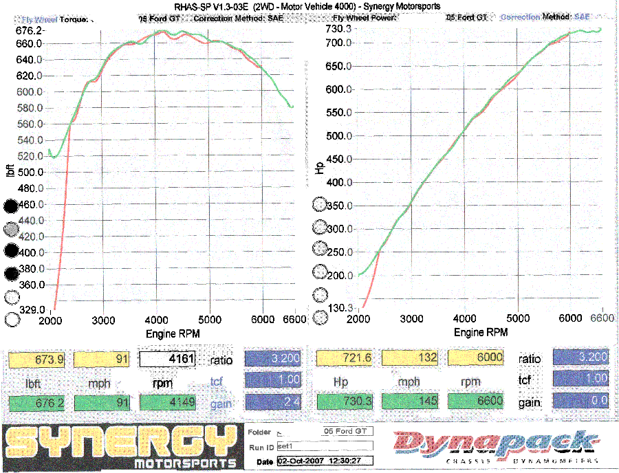

BlackIce had his gal on a dyno today spinning the Whipple to 19 PSI and put down 730HP at the rear wheels on good old California 91 octane at only 6400 RPM
He has the tune that we installed in Ed Simms gal however while on the dyno I called TonY G aka HP Performance and he worked directly with BlackIce and the dyno operater during which he made a couple personal touch tweaks specific to BlackIce's gal because she no cats at this time.
FYI: the A/F's were left extremly safe in the mid 11's and the timing was 19 degrees

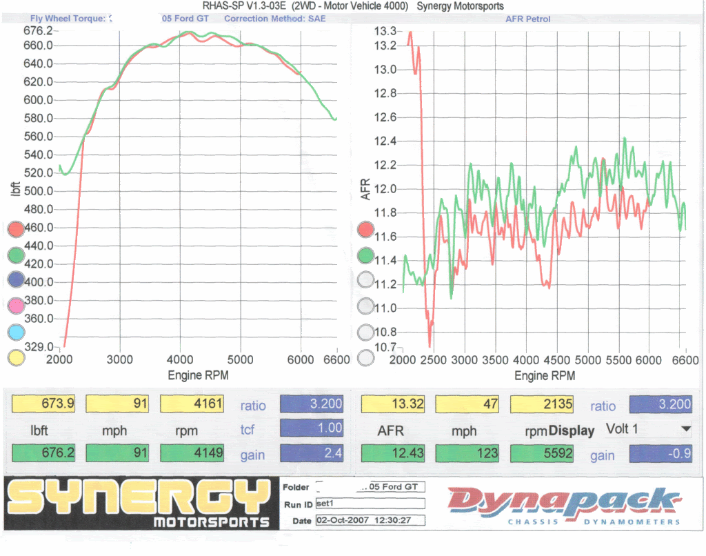

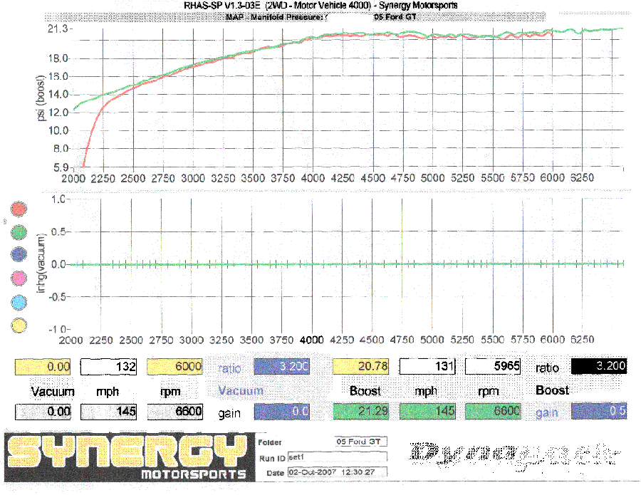

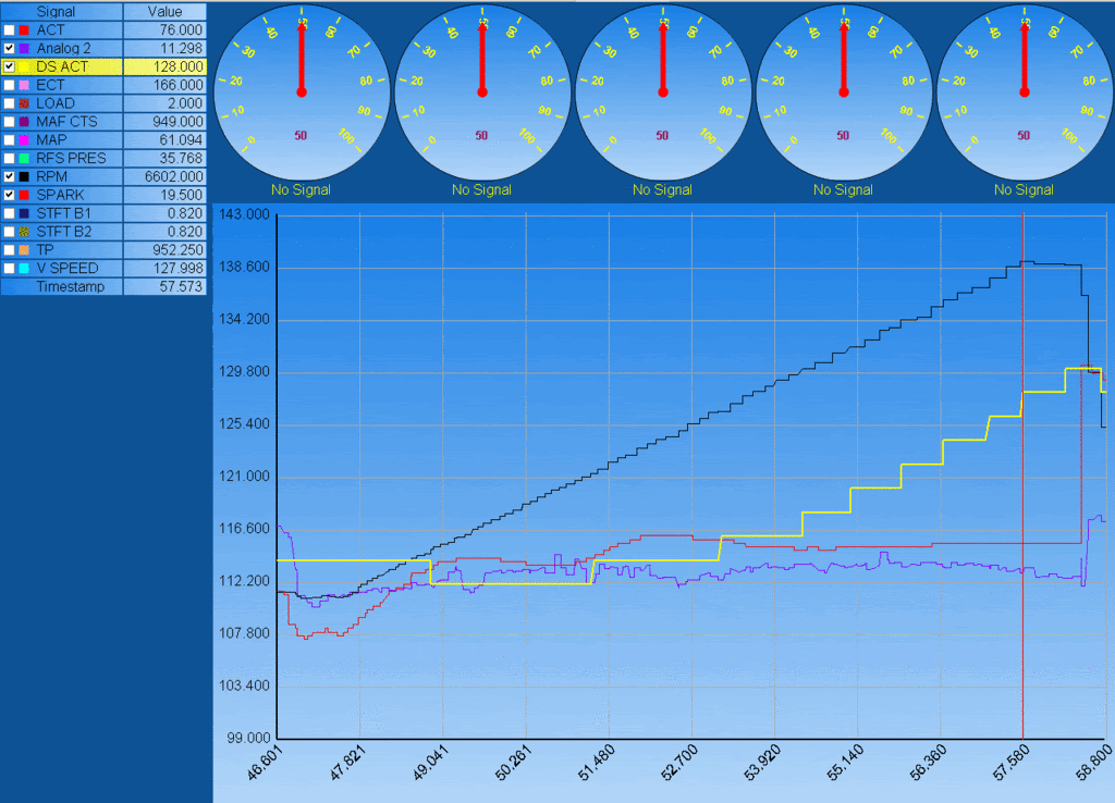

Whipple Dyno Graphs
Here are some graphs of two dyno pulls on the Whipple with a 19 psi pulley. Note that the boost went up to 21 psi with just the 19 psi pulley. The A/F ratios I logged were different than the dyno's A/F. We both were using Innovate sensors in the same location, mine was in the left bank, the dyno's in the right bank. Mine hasn't been calibrated for about 200 miles. The dyno shops, I have to ask him. Anyway my logged A/F via the Lc-1 and SCT-X2 were about 10.4 to 11.4 on the 1st run to 6000, and 11.1 to 11.7 on the second run to 6600 rpm. When I get some time I will recheck my calibration and ground offset to see if may values are suspect.
So if you are thinking pulley or Whipple just look at the dyno chart. After riding in, or driving a Whippled GT you won't be happy with just a pulley. Now if you want a Heffner TT instead, that I would understand.
A big thanks to TonY G and Shadowman for their help and support in getting the Whipple up and running. If you are thinking of a Whipple give TonY G a call. Remember you are buying more than just a Product, with TonY G you get 1st class product support as well!

Ice... great numbers, I am so very happy for you, and to think you did the install yourself. Must give you much satisfaction!! Bravo !!! :)
Black Ice Whipple
Whoa - Cool #s Black Ice. I was 6 hp off of your highs but within the error margin they are equal. Rippin', snortin' power. American muscle that will rail corners & shorten straights like no other! I love it!
