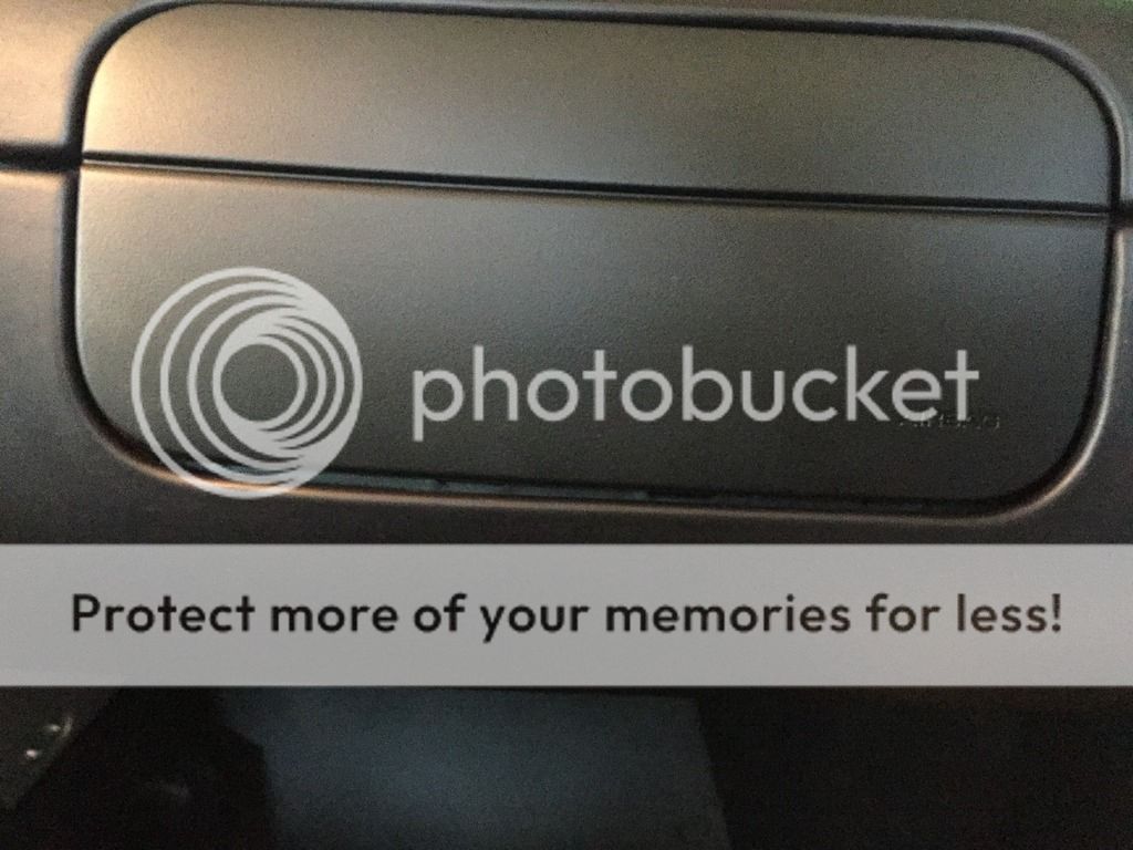

Has anybody else had their passenger side airbag replaced?
I had both airbags replaced last week, and I'm less then pleased with the passenger airbag. The dealership was great. I have no issues with their work. My issue is with the replacement airbag itself. It sits slightly higher in the dash and creates a larger gap between the bottom of the airbag and the dash.
The dealership has stated that there is no adjustment for the passenger airbag. What you see is what you get.
I know I'm being slightly nitpicky, but the original airbag didn't have this issue. Am I expecting too much?
Original airbag:
Replacement airbag:

The air bag itself is not replaced, only the inflator canister. You should have your original dash panel.

Looking at the horizontal line across the dash to the air vent, it looks like they reinstalled the left side higher than originally installed.
Hmmm... That makes me wonder why the dash panel wouldn't be in exactly the same spot. The tech who did the work stated that there is only one way to mount the passenger air bag and there is no room for adjustment.
I agree. It's only off about an 1/8", but it definitely makes a noticeable difference.
My '05 GT Shop Manual doesn't have a section for airbag removal and installation. Does anybody have a schematic for the dash and/or passenger airbag?

This website has some good info on the passenger side airbag recall: http://ford.oemdtc.com/1738/14s28-driver-airbag-inflator-replacement-2005-2006-ford-gt/5
After looking through that site, I found the section in my shop manual that covers the airbags (501-20B). After reading through that section, I am now of the opinion that the passenger airbag is in the correct spot, but the lower dash assembly wasn't reinstalled correctly. (I didn't realize that the lower dash assembly has to be removed to service the passenger airbag.)
I looked closely at the line between the upper and lower dash assemblies, and it appears the gap between the two is uneven and larger on the right side of the car. It looks like the car will be going back to the dealer.
My dealer was able to adjust the lower dash assembly this morning, and everything looks as it should. So, remember to check the alignment of your lower dash when you finally have your passenger side airbag inflator replaced.
