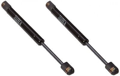

you might be able to make these work
5,198
5,198
the ends on the second ones I posted screw off you might be able to get a little needed extra length by adding an adaptor or an extended end to them.. this will increase the overall length and maybe even give you a little extra travel. the ball studs on the car can easy be replaced for proper fit also
Reactions: THamonGT

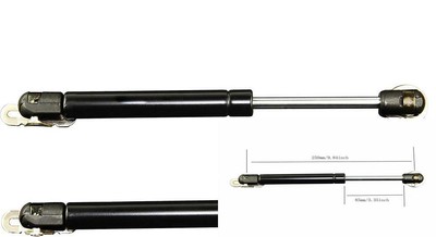

5,198
this one is almost right on the money

however unless you guys want your struts to say ford on them there are manufacturers that sell almost any length strut so finding an aftermarket solution shouldnt be impossible.
just have to measure collapsed and fully extended lengths to order one.
Disagree. It's not just the length, it's also the strength, etc. of the strut as Xcentric chided you in his posts of how impossible it is to find a non-OEM match. I'd be interested to see if you can find a match, order it, and most important, test it on your car before you recommend it to other members. I've brought several home that were supposed to fit and didn't and had to return them. Ended up ordering the OEM struts, problem solved.
Thanks, but extended length is too short (lid won't open all the way), compressed length is too long (crack hood/break something on closing), wrong ends (which are not easy to swap, because rod diameter and threads are different - coarse/fine), and the gas tube is too fat (tube diameter is critical, there is no room for a fatter than OEM tube). Other than that, the 45 lbs is correct.
Someone didn't believe me when I said I scoured the entire Suspa catalog. :rolleyes:
But, if anyone makes these work, please post. :)

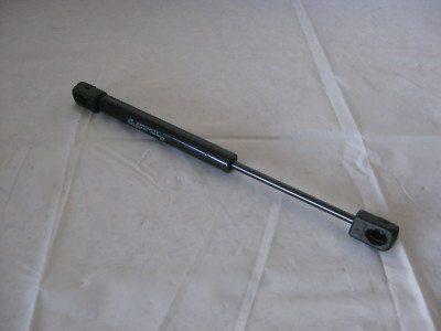

5,198
I offered some additional solutions to what appears to be a lack of supply for the OEM struts, if you guys have an overt desire and need to replace the strut with exactly what comes on the car why dont you just rebuild the old unit?
it took me all of 1 min to find these people online
5,198
this one has the exact compressed length and the fully extended length is off by .2 inches cant imagine that would be much of a difference
I couldnt tell what they are rated for and or the tube diameter but if you want to replace with something aftermarket you have to make some concessions.

I believe you did some computer searching Soroush, thank you for your efforts, but until you have ordered a set and tested them on your vehicle, I'm very skeptical and agree with Xcentric.
5,198
this will be a better option for you guys
my car doesnt need struts at the moment and I already have an extra pair set aside for when I do, however if I was in bind I would do what I have suggested here either find a new set that I can modify or just get the old ones rebuilt.
