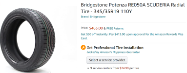

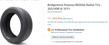

And just as a double check...these are the correct tires?
Reactions: Fast Freddy
