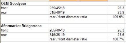

Get the Bridgestones. Most aren't savvy about the Bridgestones on the GT because they don't cross reference in the standard tire cross reference tables. They are the best solution and do fit. Make sure to get the right version for the front. You want the one with "N1" in it...
Make absolutely sure the dealer returns your tire programming to the original "revs per mile" setting.

The oem Goodyears and the Bridgestones have diameters almost exactly the same, and have been used by hundreds of GT owners.
Put the Bridgestones on and find a new dealer who has an IQ above 50.
