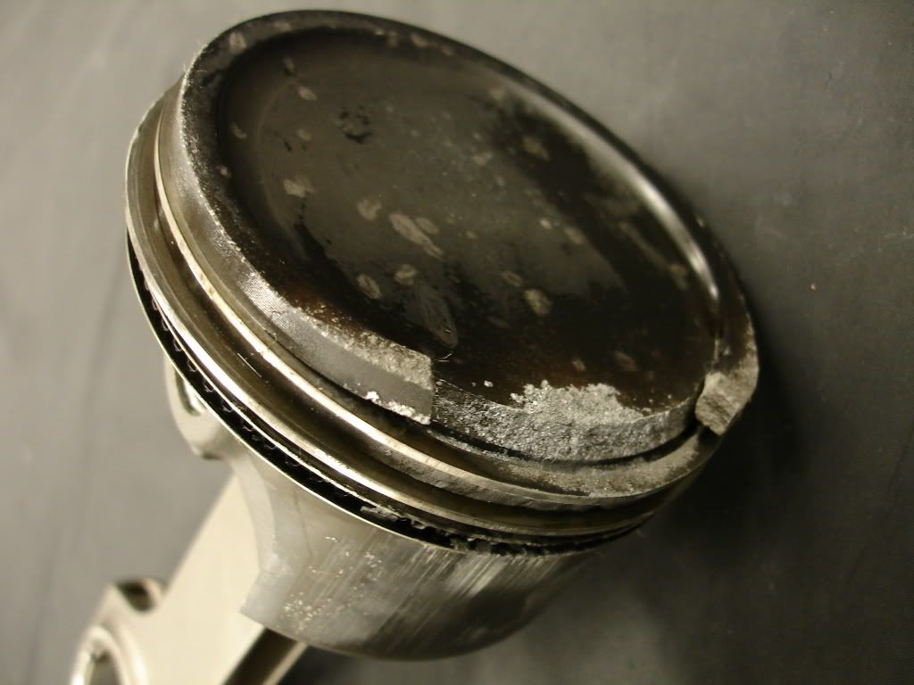

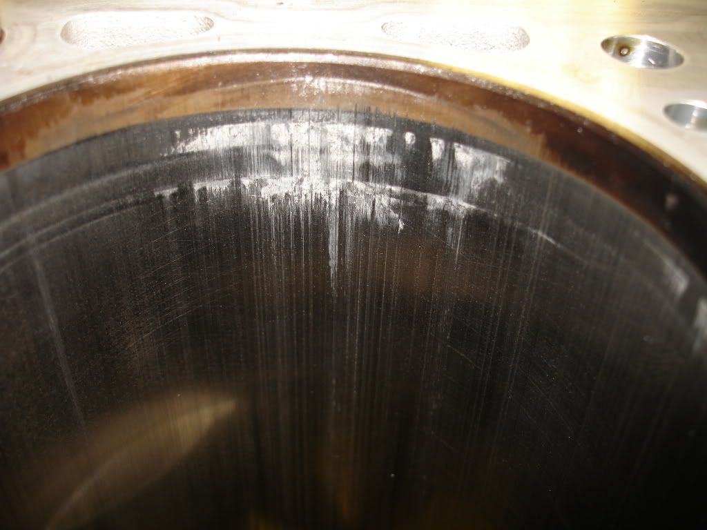

Then when at LeMans (classic lemans... on the track) I destroyed a plug.... and eventually one of the pistons gave up at Silverstone. Top land broken....

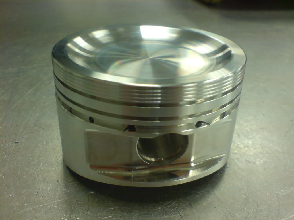

So together with Roush we decided to switch pistons to the racing ones made by JE. CR is a little lower.
When Roush/Mountune rebuilt the engine they noticed the keyway and fixed it.

Here is what happened to the piston
And here the scoring on the cylinder
And these are the new pistons that we are putting in
