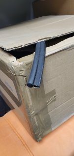

Was happy to help. If someone needs the seal for the inner horse shoe section or the perimeter I have the exact OEM material. Lock it in your memory banks or ask Frank..lol.. Happy Motoring!!
