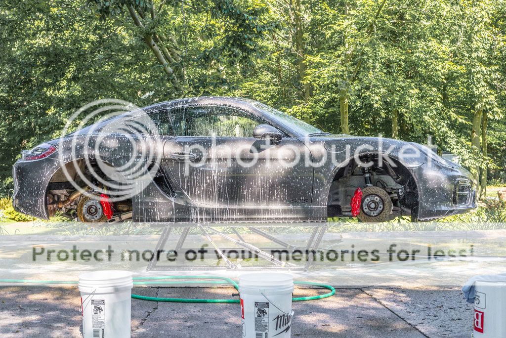

I walked into a friend's garage/warehouse yesterday who ows several sports cars (new and old 911, Focus, Viper, Corvette, etc.), he has one BendPak/Ranger QuickJack BL5000 on the floor to lift his cars about 16-20in. to change the wheels, wrap the cars before the race, fix spoiler scratches and detail the lower body. I think it is a pretty cool gadget. I was wondering if it would work on the 2005 GT since its jacking points are way inside...can the lift be placed as the other cars ?
Anyone here has seen one of these used on a GT ?

You are spreading the load over such a broad surface - let's say conservatively 3.5" x 48" for each ramp. (I'm thinking worst case is to lay a 2x4 - or a 1x4 - better still, so that you can designate where you want contact along the rockers.) so, surface area would be 48 x 3.5 x 2 = 336 square inches - or a load rating of ~10lbs per square inch. I don't think you'd have any issues at all with the GT.

Here Rock... I've the wide version of the BP- HD9 w rolling jacks... same effect but at any height i want..
this looks cool but with the FGT, as Kendall states, it doesn't look like mid pan would come off and the bigger question is do the "rails" line up with the jack point placement and width of the FGT?
