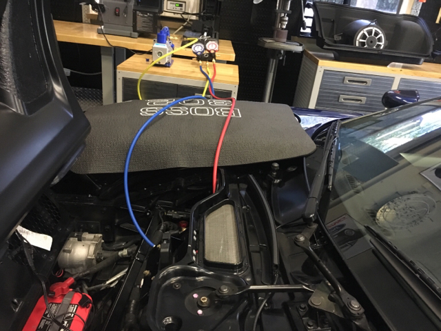

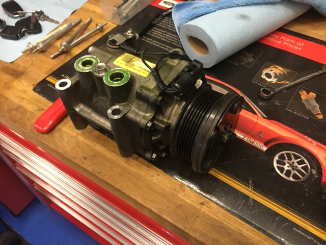

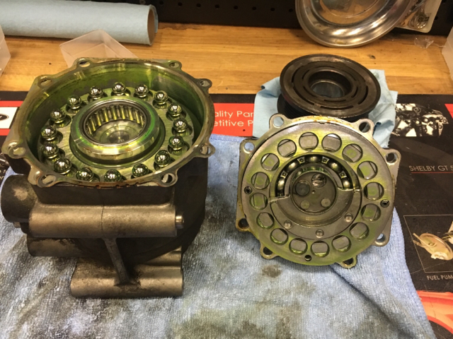

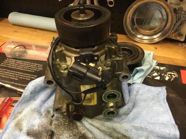

My GT's ac stopped blowing cold a while back so after some investigating I found the compressor to be leaking the other day and replaced it with the extra one from my garage table, vacuumed and recharged the system and it seems to be working fine and holding pressure now ! This after a few attempt to get a shop to look at the system to see what's going on with no luck so I just bought everything I needed to do the job myself ! Anyway for those who may be interested I opened up the old compressor to see if it can be rebuilt and it seems straight forward enough there is a large o ring on the main body and two thin metal gaskets the union between the two main bodies was in fact where mine was leaking as seen on the pics (w ultraviolet light and dye) I had my friend look up parts and of course there Is no way u can get the O ring or the thin gaskets from ford I was wondering if anyone knew the supplier or if these could be found anywhere I hate to throw an otherwise good compressor out !

Has anyone found a source for the "O" rings, gaskets, etc. necessary to rebuild the '05-'06 A/C compressor? As I believe has been stated previously, no rebuild kit is available from FoMoCo. Thanks.

If it's just the O-rings, they are $1.57 for 6. You need 2.
