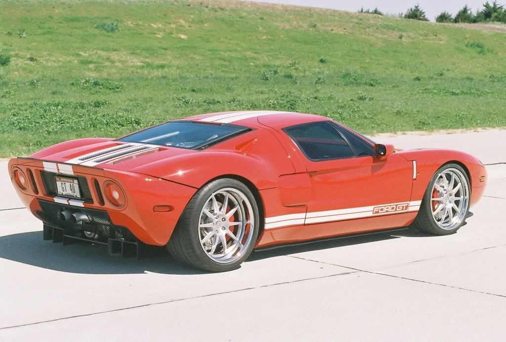

hey guys just curious to know how many gt's here are running 20 inch rims on the front and what tire size your using
If you are interested in a specific brand of wheel, such as HRE, or ADV, for example they will have a record of every Ford GT that they have made a wheel for.
My HRE's in the picture are mounted up with 255/30/20 Michelin Pilot Sports
I also have a set Of ADV's with 285/25/20 Michelin Pilot Super Sports.
Now someone please correct me here but i was told to take the 285 divided by 25 and you get 11.4 Thats your sidewall in MM
So 255 divided by 30 gets you 8.5 I can not see or feel the differance between the two.
