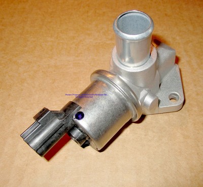

hi, yesterday driving a new to me GT with 3.5l whipple and large accufab TBs. I was doing a spirited run in 4th gear and all gauges were nominal and boost was 15+ psi. Full throttle. Then I lost power. Car still ran but now only seeing 2-3psi boost and wont rev out. I suspect supercharger bypass valve since no boost. I pulled the valve and not sure how to test it. I know unpowered it is open - not sure if that is correct.
Any help appreciated. thx Charlie

Valve is easy to check, suck on inlet and if it holds, it is good.
Can you take a pic of the supercharger valve?
charlie27
Nov 1, 2017
16
with the valve off the car, the valve is wide open - meaning bypass
this valve
