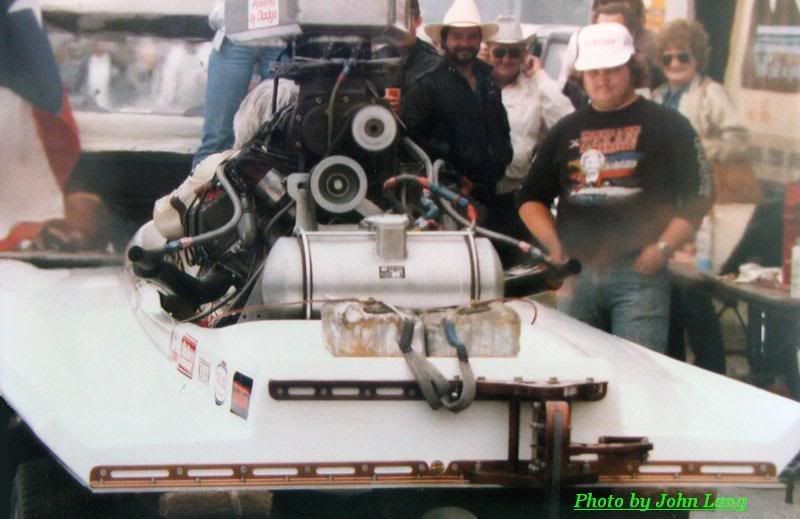

Another great day of top fuel dragboat racing-
And now on display at my Eddie Hill's dealership for Ariel Atom, Honda, Kawasaki, Yamaha, Polaris, Victory, and Slingshot. In beautiful downtown Wichita Falls,Texas. Yeehaa!
Great Pictures, Eddie!! Thanks for sharing.
Is that a Crower mechanical fuel injection intake under the cover on the unblown fuel Kindsvater drag boat? I was able to pick up one of those and replaced the dual quads/tunnel ram on my Sanger. Never put zoomies on it yet, as they're outlawed when recreational boating. Some day though....
Yes that is a Crower mechanical fuel injection setup, and it worked great on 98% Nitro. With that much Nitro, fairly high compression, and not much flywheel at all with the Lenco clutch, the throttle response was unreal!
The blown fuel guys would all come down to my pits when I warmed up, just to hear me whack the throttle. The rpm was up and then back down so quick, it sounded more like an explosion, than an engine revving up! :biggrin

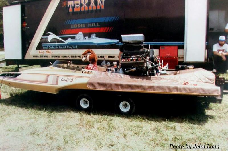

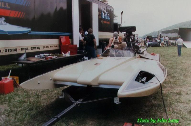

Some more of my unblown fuel hydro, by taking pictures of old photographs in my scrapbook-
This picture is so HOTTTTT, Eddie!! YOu must have had some very tall gears in your Casale!
Great graphics on the picklefork!!

RALPHIE, the gears were 1.63, and the tattle-tale tach showed 8650 on the NDBA record run, with a 11 1/8 x 20 Menkens prop.
I used 96% Nitro that day, with no alcohol in the mix.
She rode plenty free, as you can see in the pictures.

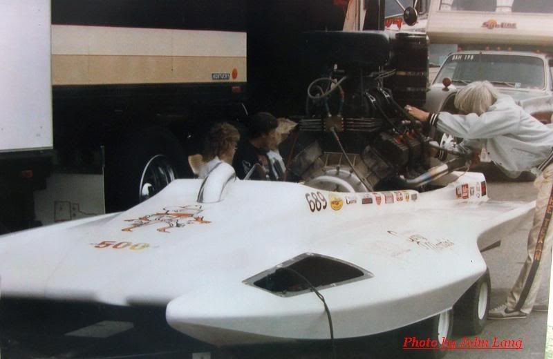

Those are some VERY serious numbers - you really had to have the horses in that engine to pull that prop and ratio! I run a Precision 11¼ x 17 on my Sanger which will only top out at around 125 mph or so if I could get the motor to achieve 7,000 rpm, using 1.25 gears in the Casale. I've only had it up to around 100-105, and that's damn exciting to me!
Back in 2005, I went over to a Sanger boat reunion where there were quite a few pickleforks and shovelnoses. On that day, the Sanger factory trailered over a newly splashed version of "Climax" (they have kept the original molds) which I'm sure you ran up against over the years.
In fact, you probably knew and raced against the guys that drove it. When I was getting my boat operational (I found it in a field outside of Ramona, CA), Greg Shoemaker gave me a lot of help - boat guys are like car guys, I guess - nice to be around, friendly and helpful.
I didn't get my boat until 1998, when I was 56, so the thought of competition never entered my head - but I can understand the thrill of pushing these machines to their limits. Here are a few pictures of some of the hotter boats that were at the reunion - I found it interesting though that I was the only one to put mine in the lake that morning and make some noise!
FourFather
May 24, 2007
460
Wichita Falls, Texas 76306
Very cool pictures. I'll bet that was a great day. I never tire of looking at well built high performance machinery.
Good on you for getting her wet and making noise--after all, that's kinda the whole point!
