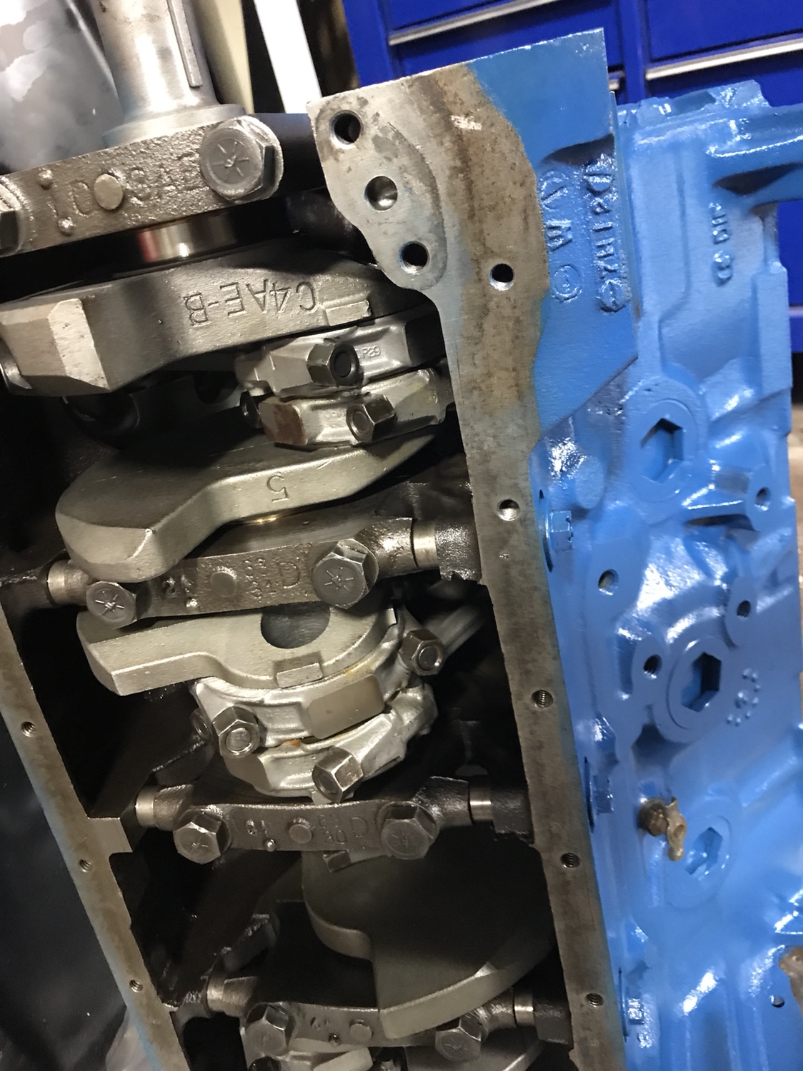

Here’s one before I started building it for my ‘70 Mach 1 project:
Back from the machine shop:

Were those side oilers or center oilers?

One center, and one side. This one is the center Oiler, which was reverse rotation. I am reusing the crank, but had the knurling reversed to sling oil away from the rear main seal. After talking extensively with Lee Holman at Holman Moody, I decided to build the center Oiler for my Mach 1 project. He said unless your spinning it up for long durations above 7k the oil supply to the mains is sufficient. The issue on the center oilers had to do with the centrifugal force of the crank spinning the oil out faster than the oil passages could flow, of which the side oilers corrected that issue.
Since this will be a cruiser, I played it “safe” with a complete Edelbrock performer package and PRW rockers. From what I’ve researched, Blue Thunder heads do flow better (Holman Moody uses them on their builds). I’m going to save the side Oiler for either a GT40 or Cobra build down the road.
