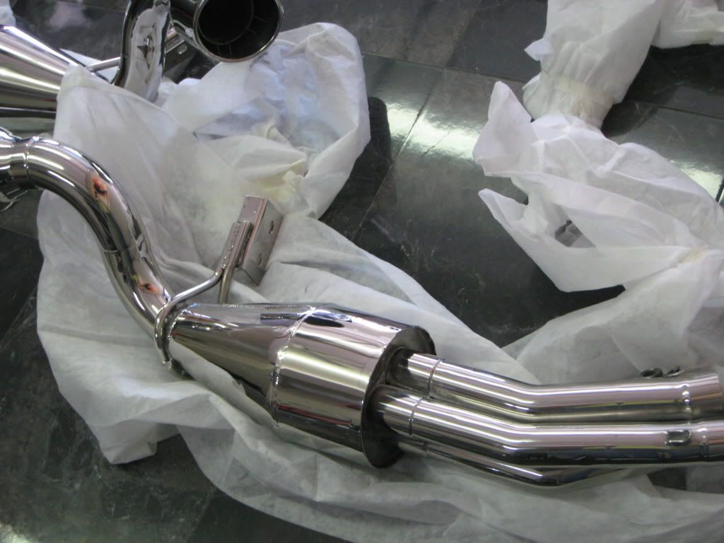

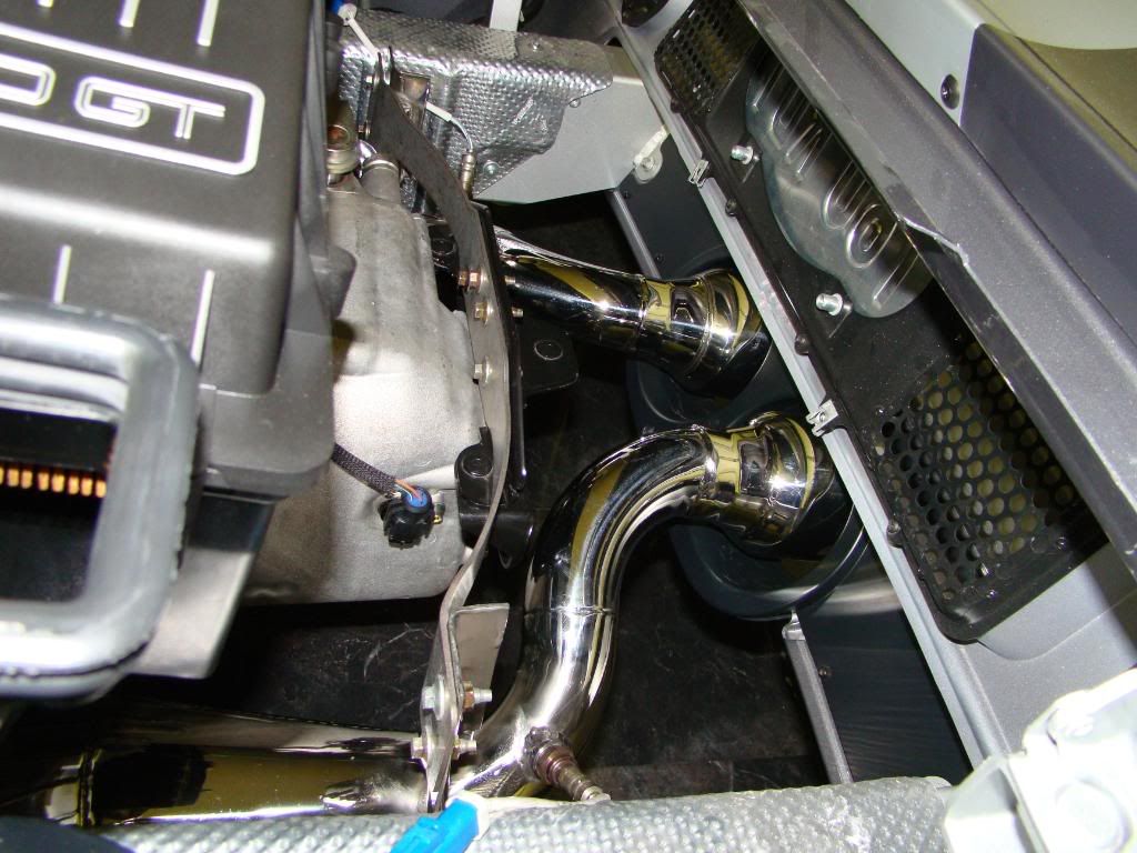

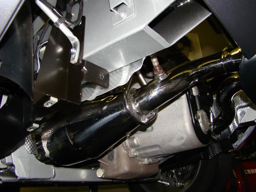

Installing my FRPP Rear Exit kit then the balancer and Metco 2.80 upper

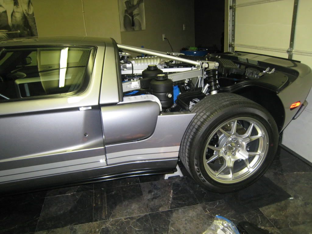

I have a lift but my Hot Street car has the Rear-end out so i decided to work on the floor which enough room for the job ,here is some pics

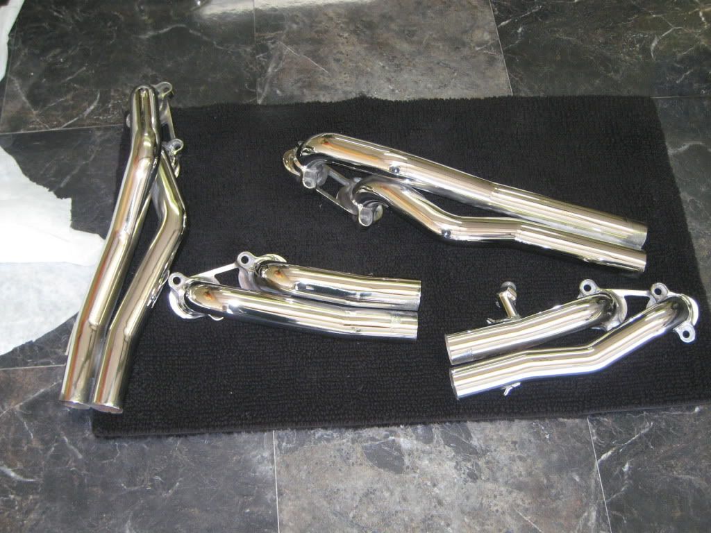

Got a local polish shop to polish Rear Exit KIt for me
This made install a little easier

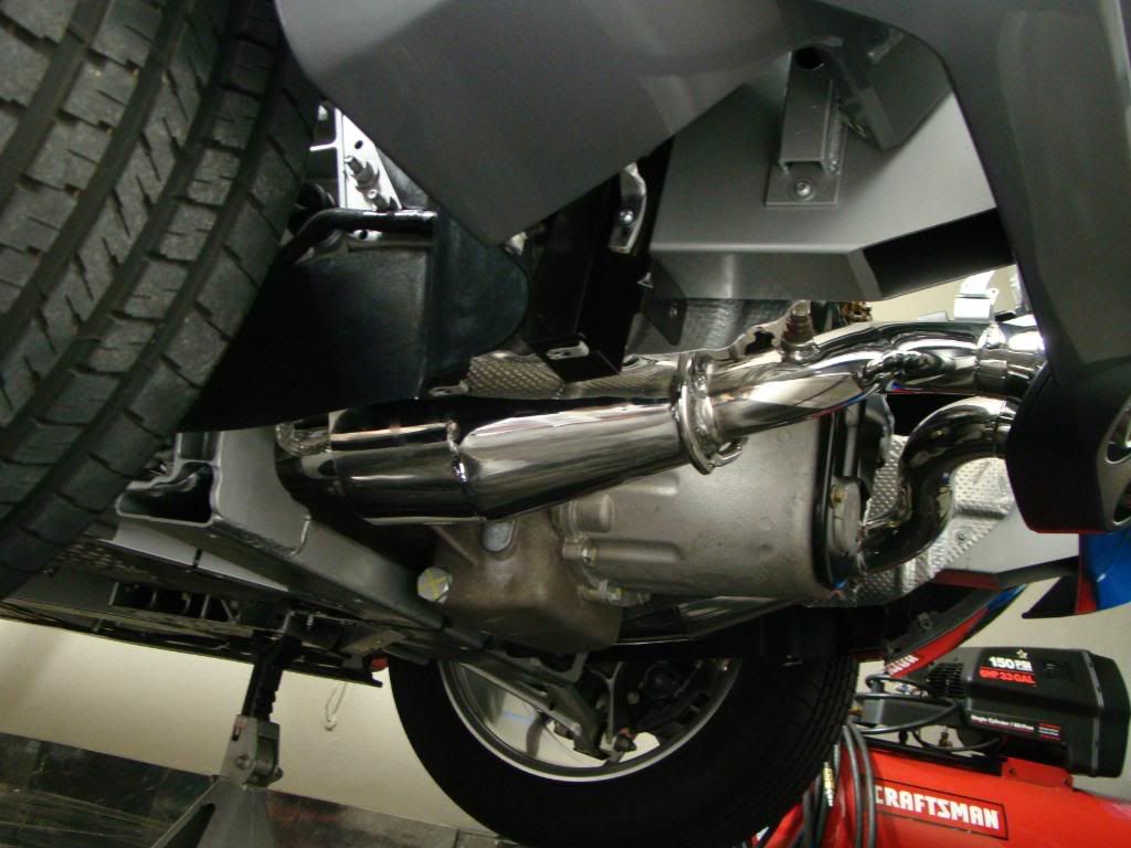

It took a total of 11hrs to install the rear exit if you are going to do it right ,Taping, covering and removing the rear hatch and bumber and acc.

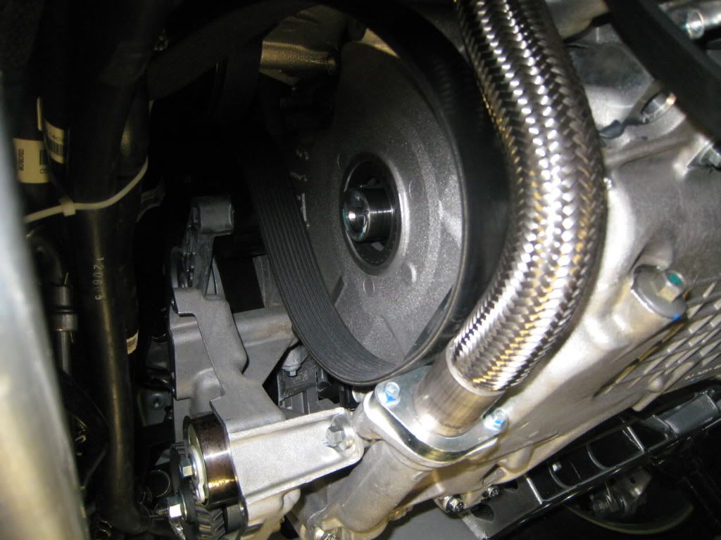

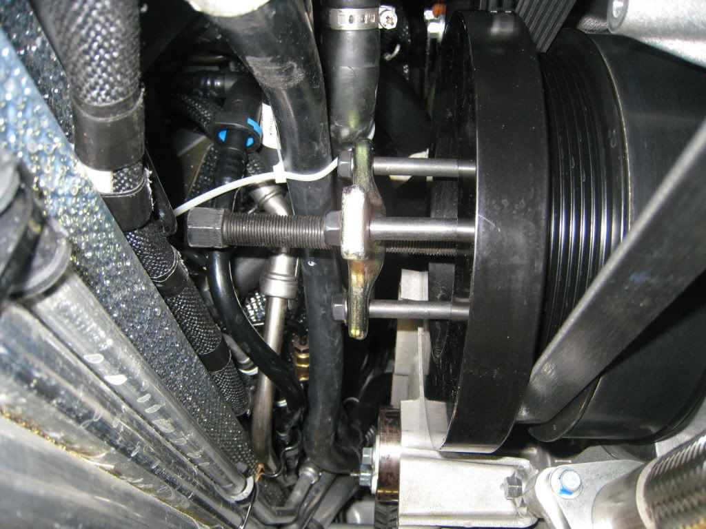

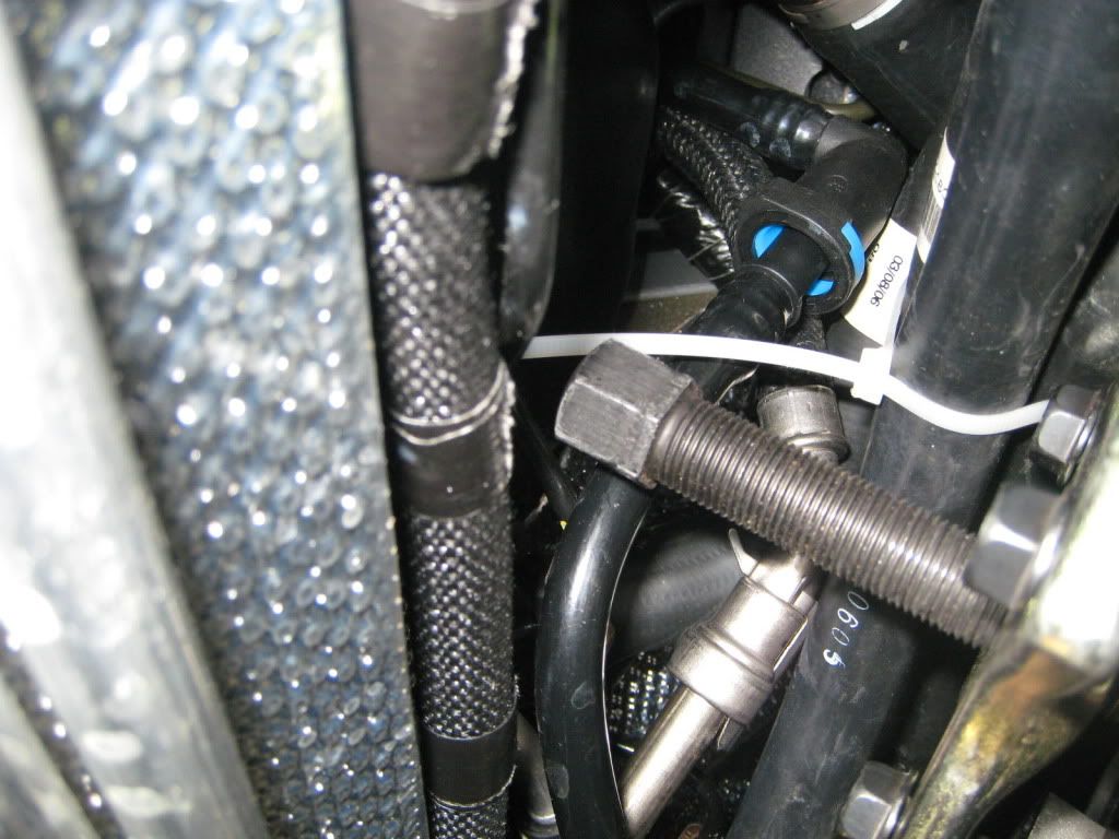

Removing the stock dampner was a straight foward process with standard tools and patience
This is the stock looking caterpillar balancer that is on all of 05-06 GT40 Supercars ,Innovative West is assmebling me a 10% lower balancer which will be ready tomorrow and i should reaceve by Friday and i will post pics of the install as well as the Metco Upper
Great post Extreme. It looks like work of art, plus I am impressed anytime an owner can do their own modifications.:thumbsup

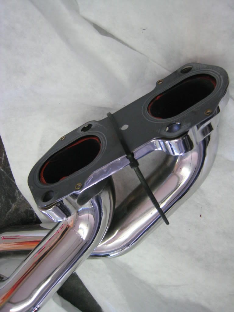

Is that red silicone sealer I see on the header side of gasket? Was this recommended in the installation instructions? I installed the same system with new gaskets and no sealant.
Looks like you answered the question about getting to dampner off without pulling the engine! That made my day!! I ordered my IW 10% and upper assembly yesturday.
How much does that stock pig of a dampner weight?

Great Post!!! And I love it that your wife allowed you to bring the car in the house and work on the Kitchen floor.:rofl:rofl

Love the Buzz Lightyear beach towel floor protector. Makes working on the car a family activity. Great that you're getting 'em involved at an early age.:thumbsup
From time to time I still use a Power Ranger beach towel as a fender protector. And my kiddie's, now in their 20's and 30's, never fail to remind me that it's only "on-loan". And subject to immediate return to it's rightful owners. :lol
No just a precaution i take to header leaks ,any kinda leak brings up cylinder heat but im sure the stock or Percy gaskets will be fine without it .
HAHA right ,i have a 2yr old daughter that helps with the misplacing of bolts

The I.w Balencer is 10 lbs less then the Stock one! That is alot of rotational weight!!!! Plus on the I.W the balencing weight is closer to the crank as where on the stock balencer is on that outer ring @ 7inches. Super nice piece it is and Ford buys these balencers for all the Cobra Jet races cars and ford Choose them over everyother company when they did testing on them! :thumbsup
It is nice to know that the balancer can be removed with the engine in place. :thumbsup
Rotational weight is not equivalent to rotational inertia. The weight being confined to about a 4" radius. But 10 lbs saved anywhere is a good thing.
