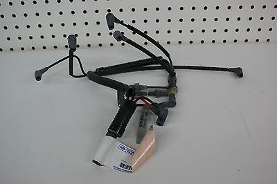

Look into part 4G7Z9E498AA connector , less than $75, rear most vacuum line connector on passenger side rear of supercharger. Sort of an octopus vacuum line assembly. Mine was loose and sucking air after 65k miles. Some similar symptoms and a O2 code when it gets bad enuf. Plugs should be good to 100k, just had mine replaced.
https://www.concord-parts.com/images/items/ford/4/4g7z9e498aa_ford_2.JPG
Thanks for the suggestion and part picture. It sure is an octopus. I'll check it tomorrow. I know plugs are supposedly "100Kmi" items now, but that seems a bit long to me. I will at least pull and inspect them, and put antisieze on the threads--learned that the hard way when I drove VW air-cooled engines several decades ago.
