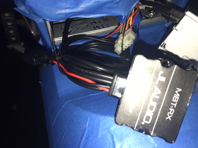

I installed the JL module today. It was pretty straight forward and it syncs with my phone automatically once paired. The audio is clear and volume is loud.

It looks like you used the yellow/black wire for power. Is that the switched power source? It also looks like the black wire is ground, correct? Since I'm about to do the same, it'll save me a little time perusing the wiring diagrams.
1,775
Yellow/black tested out as the only switched 12v+, but there are 3 wires a pink/blue stripe, brown/blue stripe, or black/white stripe all showing 12v- so to be safe, I put the ground on a ring terminal to the chassis.

I always try to be minimally invasive, especially when it comes to a cars wiring harness. I chose an in line wire tap since the amp draw is negligible and it doesn't cut the wire. I did this only for the switched 12v+. As for the ground, I used a crimp ring terminal to the radio chassis. I could uninstall the unit in 10 minutes with no damage to the car. Like someone else said in this post, use plenty of blue painters tape to protect all of the aluminum surfaces. I even wrapped my small flat head screwdriver with tape that I used to pop off the little aluminum side pieces to the radio.
