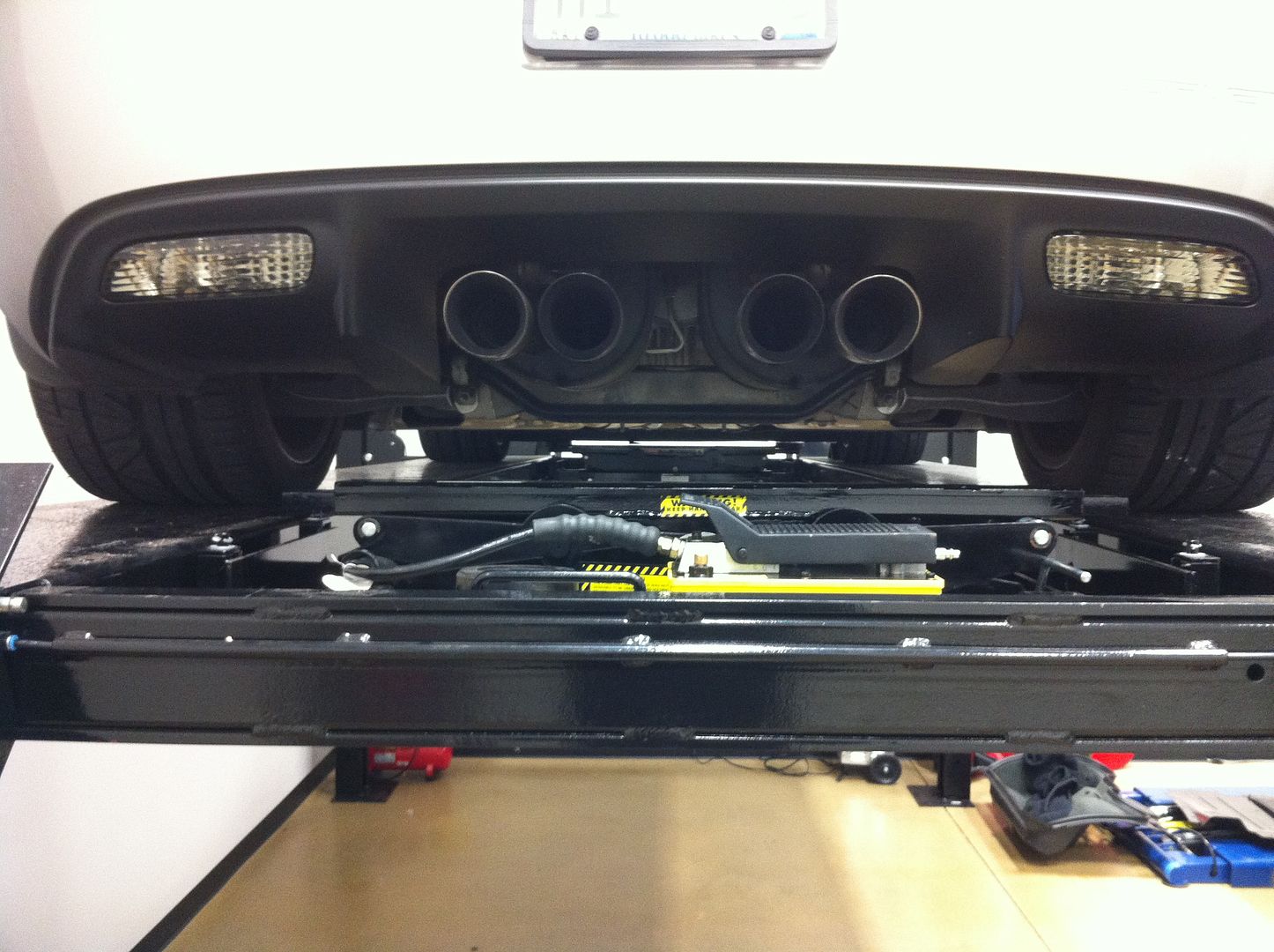

These formerly were 'sliding' bridge jacks - on a blocks of plastic/poly. They are now 'rolling' bridge jacks and use a concave wheel that rolls on the top edge of the four post's bridge jack channel. The wheels do not roll 'inside' the channel, thereby eliminating the need to keep them operating-room clean.

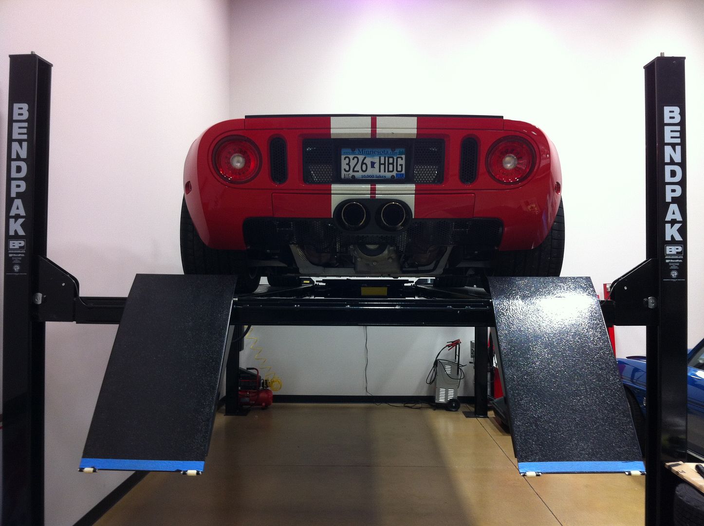

After reading on another Forum thread regarding the use of RJ-45's with low ground clearance auto's, I emailed Jeff Kritzer at Bendpak directly. He alleviated my concerns and informed me that the current RJ-45 configuration - coupled with my relatively new HD-9, allow the bridge jack to sit as low as possible relative to the ramps.
The net result provided a very low 2.75" drive over height (no pads) and 3" clearance requirement with pads. My GT is lowered about 1" and the lowest point off the ground is 3.5". I must be doing something right :)
My HD-9XW is setup on the wide setting - that is 44 3/8" between the ramps. The RJ-45 adjusts to allow for use on both the narrow or wide settings.

No time to jack anything up, but I tried both my GT and my Z06 on it with no clearance issues. The Z06 was the guinea pig with the bridge jacks at opposite ends. No trouble. When I drove the Ford on the lift, I chose to push both bridge jacks to the front 'just in case'. :thumbsup

Are those foot pedal airline controls?

They look like foot pedals but are hand actuated. Lift one side, release on the other. There is a manual safety that must be cleared before the bridge will lower. Pretty slick.
Those rolling jacks are very nice. I only have one and would like to get another. Be careful when loading or unloading a car with a jack in the rearward position. It might be possible for the car to hit the top of the jack when the car reaches the breakover angle. I know this is possible on the lifts with taller runners. I must move mine forward to prevent contact.
actually - yes but you use your hands to activate.......
i like the rubber bumpers... older versions did not have which allows the moveable arms to retract inside the jacks beam....
Good reminder. I used my Z06 as the test car with the bridge jacks at opposite ends.. I just barely nicked the rear jack so I wised up and pushed it forward before driving the GT on.
The round pads are drop in.
Once removed, the extensions slide most of the way back in. You can see them partly pushed back in here:
