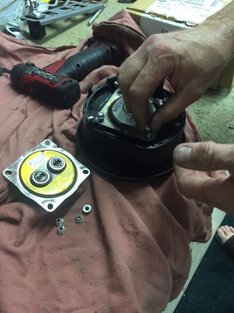

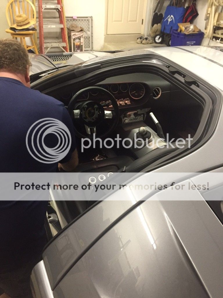

I called my local Ford dealership in Fort Myers. They have the parts in stock, and a dedicated mechanic that works on and is familiar with the GT's. I asked about them coming to the house to do the swap per the "Customer Satisfaction Program 14B09" and they said they would get back with me. Got a call within two hours and they made an appointment with me to meet at my residence to do the work. Great job Ford!!
Planecrazy232
Nov 28, 2012
79
Cape Coral, FL

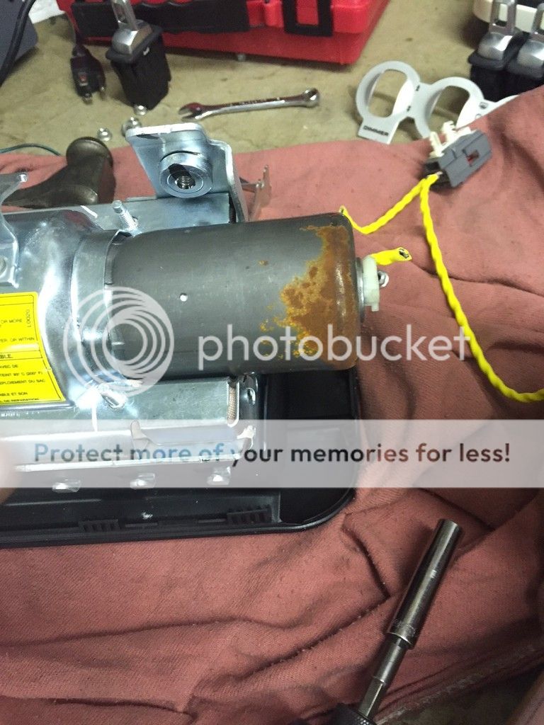

Ford mechanic came to my house today and replaced the driver and passenger airbags. While the lower dash panel was off he allowed me to replace 3 of my switches that the LED quit working. Great experience and all from the comforts of home. He says " I wouldn't want to drive mine to the dealership if I didn't have to!!"
Interestly he commented that of all the hundreds of airbag parts he has installed, the worst looking ones are always on garage kept, climate controlled garages. Ten year old daily drivers do not look as bad. Notice on one of the pictures below how rusty the metal is on the crash guards behind the lower dash panel. Mine was much better than on other GT's he has seen. Maybe because the a/c does not get run often to dry out the interiors??
