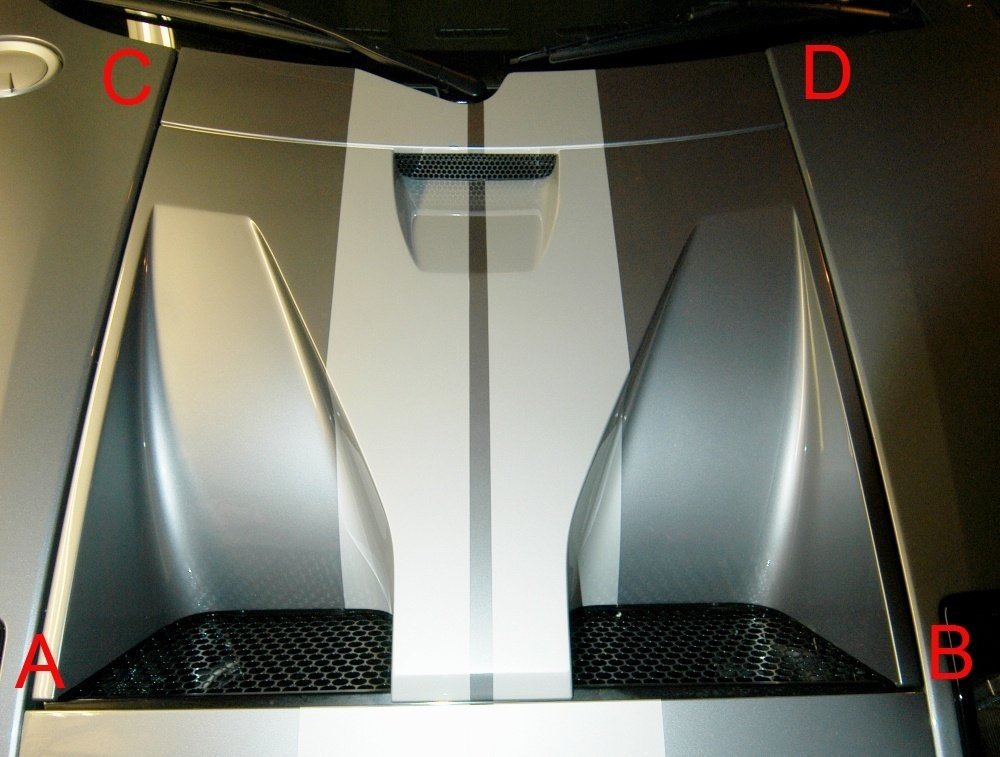

I'm pretty sensitive to body panel gaps (the bmw z8 crowd are in a bit of a tizzy over this one - they can surface as a symptom of a potential frame warping issue - my z8 is warp free).
The GT had misaligned panels around the hood and the panel aft of the clam shell on the rear quarters. So after having read the posts on this board I took the GT down to get the panels aligned. I talked to the dealer and illustrated the panel problems and he agreed that they needed fixing.
When I pulled into the shop there was another GT in the shop for a service and to my amazement the panels were identically misaligned.
I decided not to proceed with the panel alignment as I figured that it was engineered to be like this. I've also read somewhere that Ford developed a special panel fixing screw to ensure that all the panels were correctly aligned.
I've linked in a several photographs to illustrate the panels. I was wondering if they are all like this?
Don't get me started on the gaps on the clamshell. From certain angles it looks way off, so much so that a friend of mine with a body shop asked me if I wrecked the car!
Even worse bend down at the rear quarters of the car and look at the rocker panels behind the door, doesn't it look like you have a bunch of dents in the rocker?

There has been many posts on this and I think misaligned panels are common place but I don't think there is any consistency to them. I don't see any flaws in the rocker, paint or otherwise.
Damn, those are some gaps. :eek
I'd imagine it wouldn't be that hard for a competent dealer to realign them.
On my drivers side door, the "Ford GT" sticker is 1/4 higher than where the sticker resumes behind the door. The door is off the same way but only about a fat 1/8th. I was thinking of having them both fixed but the paint is so nice in the jam/hinge/bolts area, I'm thinkink of leaving it. Wouldn't they have to scar up the bolts and leave a new paintless footprint as the hinge is moved?
The rocker is a bit warped on mine as well but the rest of the car is very straight.

Not that this is any excuse for poorly aligned panels which many GT's exhibit, but the gap at the rear quarter of the clamshell suffers from the optical issue of perspective of the compound curve in relation to a straight line. When viewed from the "straight-on" perspective from the side, the gap on my car is uniform. When I follow it around the entire seam, keeping my perspective straight on (so to speak) the gap remains constant. However, when viewed at the 3/4 perspective from the rear, the gap "appears" to be too large, which is actually somewhat of an optical illusion because of the compound curve and its relationship to the appearence that the gap has narrowed elsewhere on the "clamshell". I am sorry for the rambling, but try it out on your own cars. Start at the gap on the front of the clamshell at the driver's side and look at it directly on (at 90 degrees) and then walk the seam, holding the same perspective, all the way around to the other side. I think you will find that the actual seam is quite uniform (although on my car the passenger side gap gets slightly larger). This adjustment cannot be done in a manner that the seam looks uniform from all perspectives due to the nature of the compound curve involved. JMHO.

My GT has very poor panel alignment - Roushe engineering here in the UK have adjusted where possible. The rear clamshell was way out (and DBTGT, I know exactly what you mean about the curve Vs straightline), I could put my thumb in one panel gap but not even my little finger on the other side in the same spot - this is the bit Roushe successfully adjusted. Interesting that the tolerances when the clamshell opens are minute, so it's a tough engineering angle I imagine.

Oh well, I was going to leave the panels as they were, but the one that really really bugs me is the panel aft of the clamshell and especially the curve down to the rear wheel arch. It's the same deal as yours Neil - thumbs one end and next to nothing on the other. Having read that you've successfully readjusted that one I'm going to have them take a look at mine.
biffom..who you having look it at SM Ford? and BTW you joing us on sunday?
Biff, mine was adjusted just fine and now no longer catches my eye as being odd looking. I was very kindly sent, by someone on this Forum, the official decklid flushness chart. That area - which is Area 3 - should be within .21 - .33 inches.
Because I've read of a few difficulties with dealers here and there, please double check, in the presence of your dealer, that the rear panel behind the clamshell (the panel with the tail lights in) is unscratched BEFORE they do the work.
The tolerence when the clamshell opens (i.e. the gap when opening) is really very small in this area - if they over did it, the clamshell would rub against this panel.
