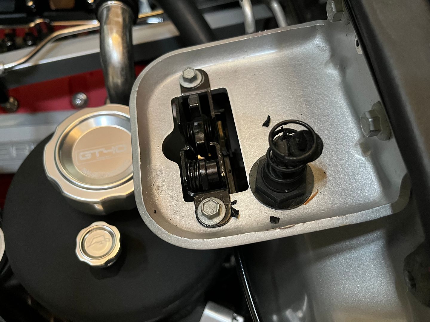

So…. I converted from the solid bumper to the sprung bumper along with my GTG’s clamshell lever bar about 13 years ago.
All was great for the first 9-10 years. Then the rubber cap failed. No problem, I bought spares and I threw another set on. That set lasted about 15 months. I have subsequently replaced them several times with each lifespan becoming shorter.
Last spring I was told Ford was out of stock and that remained the case until my dealer contacted me saying they were back in stock. I thought maybe this meant newly minted and more likely to last years. I installed a set to go to Griot’s Garage C&C which is about a 30 minute drive. The brand new set did not last long enough to make it there in one piece;
I tried a couple of suggested fixes and none of them worked for me.

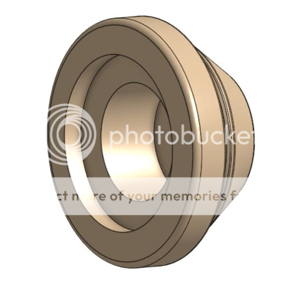

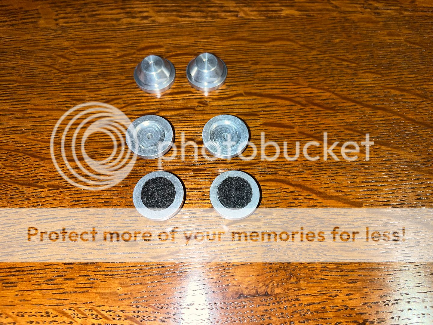

I had my machinist cut me about 25 sets of aluminum replacements.
You can see a flat was cut in to accommodate where the spring doubles up at the top. There is also a pass through hole if someone wants to powder coat or anodize them (needing to be on a wire). They have a definitive snap into place and are retained by a milled retentive groove. They are a copy of the original OEM rubber piece with the addition of the flat and the recessed area on top for the insert.

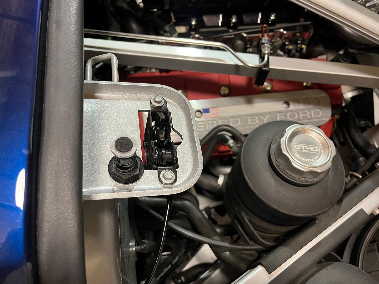

I found some heavy bodied felt inserts to act as a cushion. I think the felt is tough enough but the adhesive may not be aggressive enough. I am having some ABS inserts made too. Those can bonded in with 3M 5200.

I used a grommet similar to these from Home Depot that is smaller on one end (shaped like a mushroom), however, mine is a black rubber grommet about a 1/2 inch diameter. They are usually used to insert in a hole to protect wires going through the hole. On my GT, the small end went inside the spring and the large end covered the top of the spring. It has lasted over 10 years now, much longer than the OEM lasted. Just go to Lowes, O'Reily's, etc. and search through their drawers.
After talking to the machinist, we are going to modify the aluminum to accept a milled piece of ABS plastic. This will give great surface area to glue the ABS into the aluminum as well as centering the ABS within the aluminum.

I was in Ace Hardware this morning and saw some rubber "Expansion Grommets" that I think would work very well. A lot cheaper than custom milled bumpers I'd imagine.

So far, I am at about $30 a set, ( haven't checked into anodizing yet) but I am expecting long term results.

Got it guys. Machinist is working on ABS now.
Interference fit - no need for glue. Very nice option for GT owners.
I hope so. I originally suggested a Morse taper of about 5° but I guess machining plastic to that level of accuracy is a bit challenging.
Mine are in excellent shape and look original. Suggest using standard available ABS shape if possible instead of machining one so they can be replaced in the future if necessary. Please put me down for a set. Thank you.

Why not machine the whole part out of ABS, nylon or UHMW?
