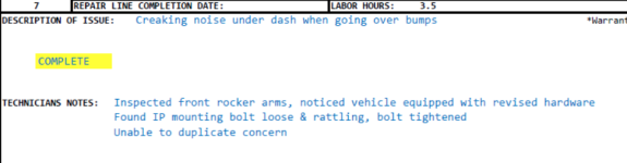

Thanks for all of the advice. I am posting the Ford TSB that I got from the dealer. Parts are on order and then time to repair.
