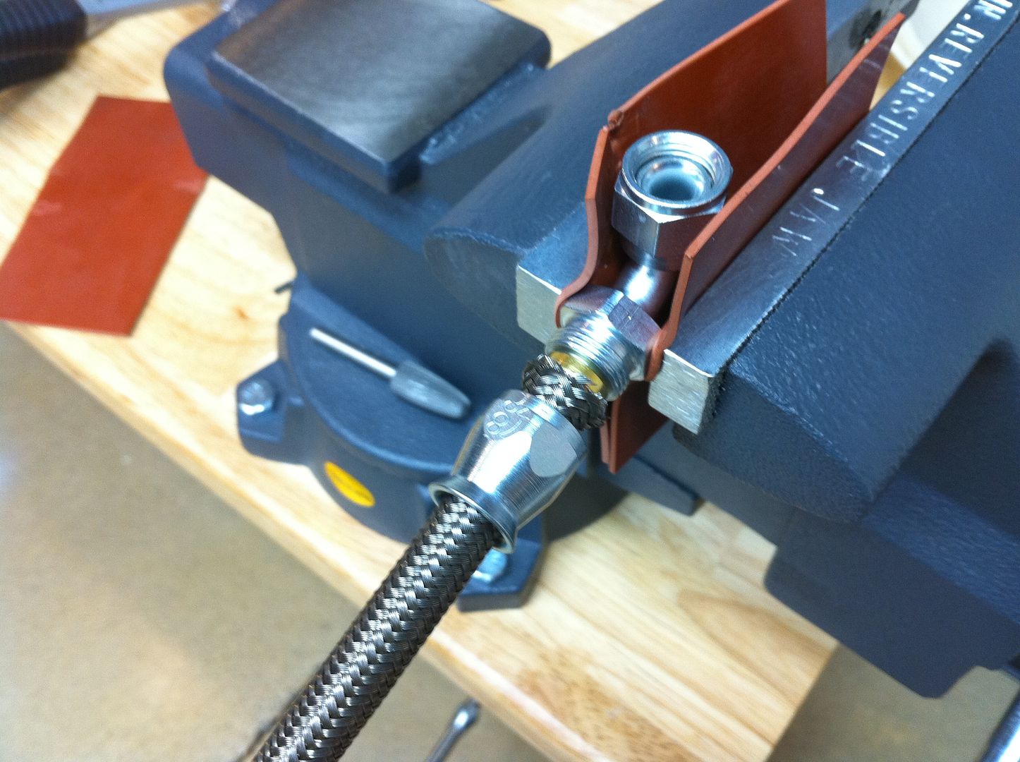

  • Except in cases of a few super-pressure industrial lines (crimper fitting), hand tools are all you need for fittings.

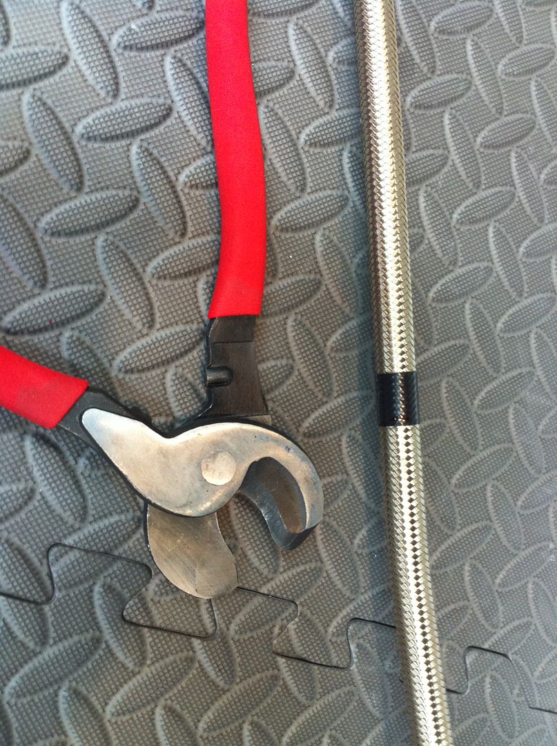

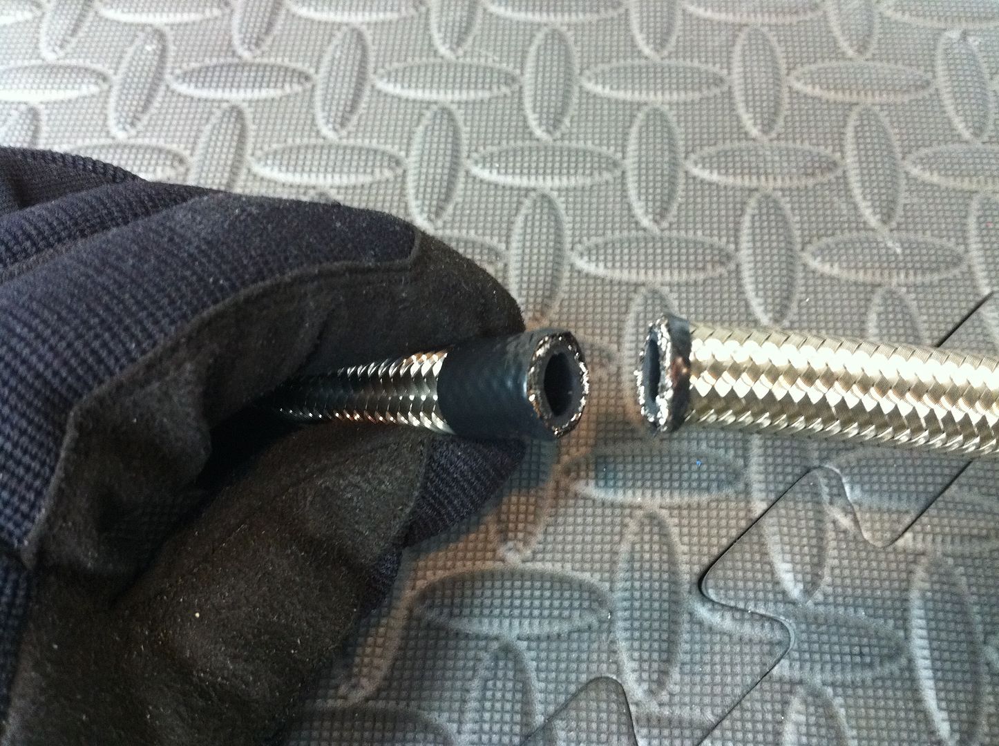

  • In virtually all cases, you can cut braided line a bunch of ways: chisel, dremel, hack saw, or the cleanest/fastest/simplest way: a $10 cable cutter from Home Depot.

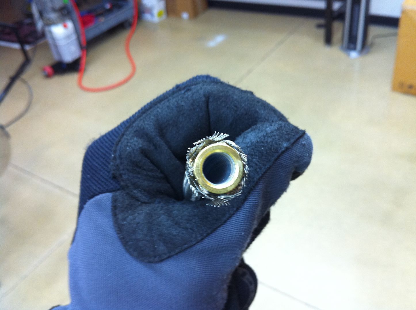

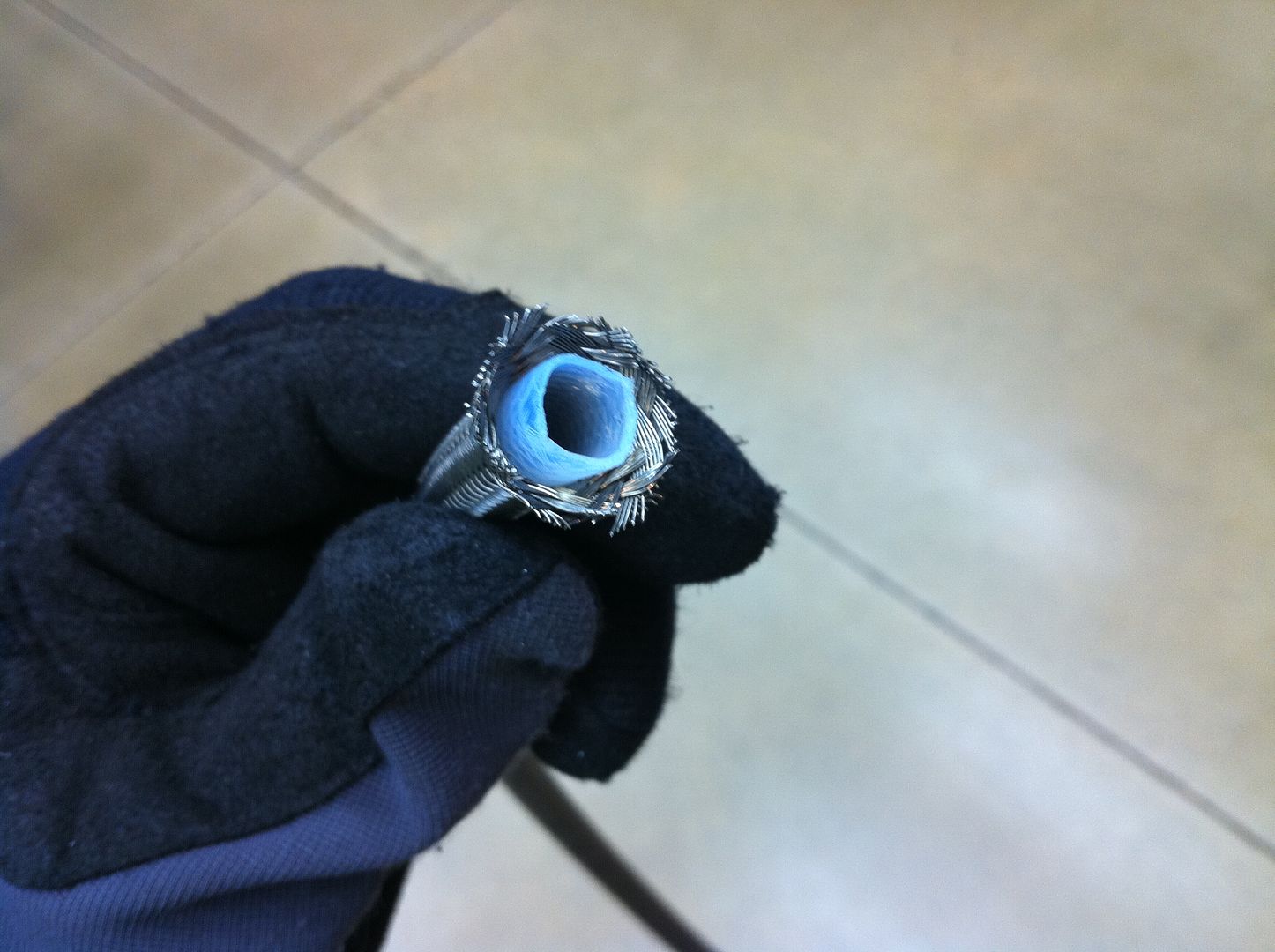

Standard AQP braided immediately below:
PTFE (Teflon lined-high pressure) hose. Note the acorn (inner brass fitting):
