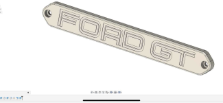

My new supercharger kit is very very close for the 05-06 Ford GT Supercar! Hope to have the first batch of 4 blowers built with in next two months. Have two pre sold already and the billet stuff is being made now. My first test kit is maybe a week or two out.
I’m using the TVS 2.65 rotor pack from the 2020 up GT500 and raptor R. Custom billet baseplate, pulleys and billet rear inlet with ford gt logo or can be ordered with out a logo. Blower casing will be cast along with the snout. Going to be able to offer custom finishes also for powder coating. Most common will be an oem type silver and probably black.
We’ve seen this rotor pack make 925whp on a Ford GT based engine with stock GT cams. It’s also capable of about 1150-1200whp on an engine with cams, ported heads, some more compression along with good octane fuel whether it be e85 or 110-116 octane. The market for that power level is very small but at least there will be an aftermarket blower option still available for these cars and will be great for that 750-850whp range aswell.
These superchargers are super efficient and that’s why the oe’s used them. Less inlet temp heat, less stress on the crank pulley due to smaller rotor pack and if you have followed the amount of power being put out by these supercharges on the 2020 up gt500’s you will already know it is a really great supercharger.
I should have a car on my chassis Dyno in April. I can back to back it against a 4.0 whipple also if anyone would like to see the difference.

Just finishing up the inlet today.
