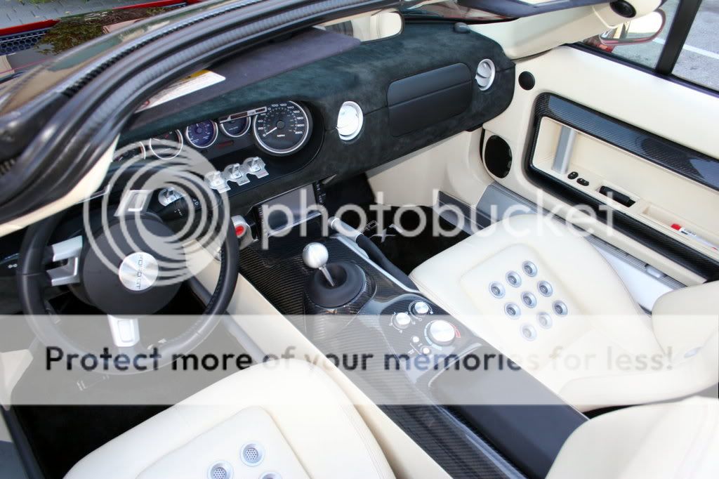

carbon door trim rings / repair of aluminum rings
Are Carbon Fiber panels available?
I offer a carbon door trim ring set. They are complete replacement parts, not just caps or replacement of the rings themselves.
Other images of carbon parts at;
http://s202.photobucket.com/albums/aa145/kipewing/
Please pm me for details.
If you want to repair the aluminum ones, I recommend Evercoat Maxim 885 adhesive. Be sure to use the adhesion promotor matched to the adhesive.
The substrait for the door trim rings is polypropelene. Very few adhesives will stick to the material. In the development of my carbon parts, I did a number of coupon tests to determine the best adhesive and found that the Evercoat product is quite good. Be certain to remove all of the PSA tape from the aluminum part, prior to applying the adhesive.

mine had tabs....no tape.....and they even needed a little "talking to" to get off when I put Kips CF rings on.

I put Kip's CF door rings on this weekend. I love the look. After owning a Ferrari F430 for a month, this is the way the GT should have come. I now have the 4 piece CF aero kit, the non-Mac CF engine cover pocket panel, And, Kip's CF door rings. Just waiting for Kip's CF gage panel and I will be done. I like the OEM mag. tunnel. IMO it looks like a structural element in the car. Not as far along as Bony, but I'm getting there.
Kip, your CF pieces look fantastic. Thanks for contributing to our community.
