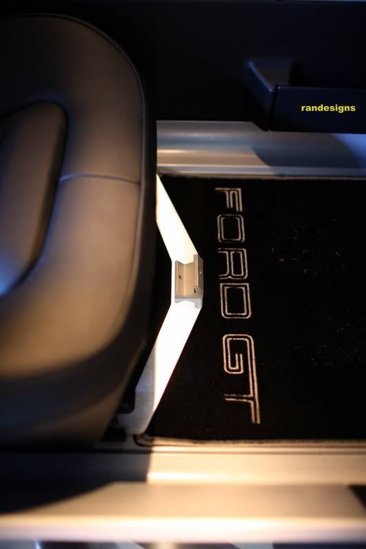

Cheers! Thanks Wally (skills), Pete S (parts), and BlackIce (tech advice) for helping me properly mount my bracket. It was tough to get the bolts back in, after removal. I watched as Wally was able to manipulate the seat rails enough to get the bolts into their threads, something I could not do alone. Removal was a piece of cake, but Wally also mentioned, that although the wobble extension is good for removal, it is not so good with installments.

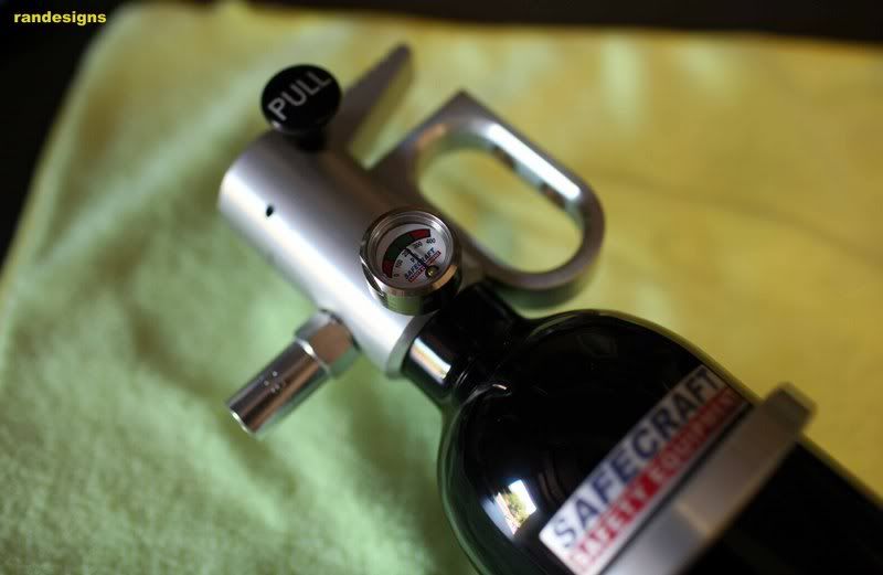

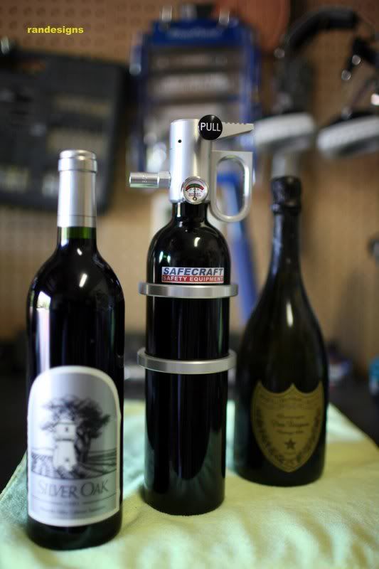

The black extinguisher would not look out of place in a wine cellar. Beautiful finish. In fact, each and every component of the entire kit is well done. Bracket itself is a beauty in its simplicity and purposeful design.
