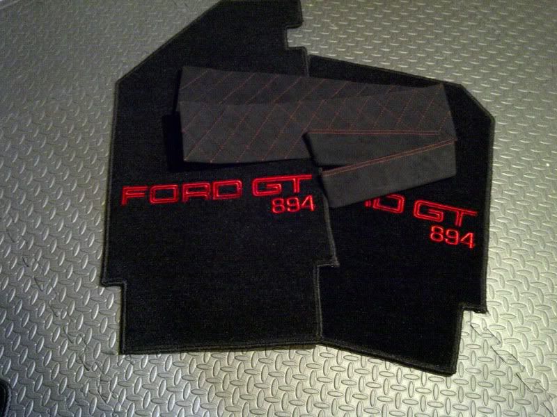

A new member, and the GT bug has already hit! :lol
Just shipped these out to Frank a couple of days ago!
Custom mats, Alcantara door pads in RED Diamond Stitch and Red Stitched Alcantara Arm rests! :thumbsup
Enjoy Frank!
