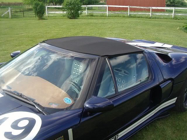

Hello all X1 owners. I'm happy to announce that our wait for a soft top is finally over. This has been in development since 2007. I want to give a huge THANK YOU to Steve Hemstock for taking this job on, and persevering through some really difficult challenges. Shadowman, for all his time on how to make the parts friendlier to the cars, the machinist, and us owners. And I can't leave out Kip for his advice on various parts of the project. Big :thumbsup to all of you.
The price from Steve is $6,500. You will need to contact him for instructions on what he needs to get your top done. It's basically a pattern that is drawn onto a piece of plastic he'll provide you with. His number is 715-702-2727.
Steve tested the car to little over 100, and reported that there is no wind noise, and no squeaking. He's to chicken to drive my car any faster. :lol He also poured water down the back and nothing got through. You might notice the water stains in the photo, those are from the previous Genaddi supplied window.:frown There is a concern in the triangle A Pillar / Door area that might leak if the car is sitting in a downpour. I'm hoping that Kips new door cap will help, the car will be going to him after a visit to the GT Guys later this week.
The top can be stowed behind the seats, or in the front bonnet. :wink
Since photo's are always a must on this forum......
Top on

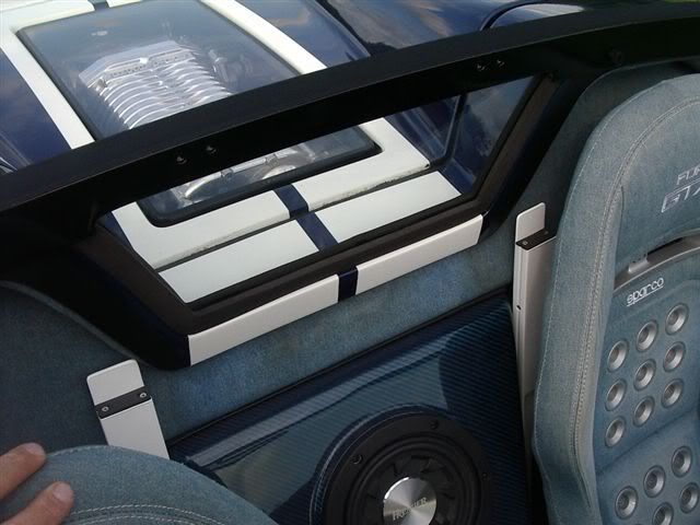

Inside View Rear Glass

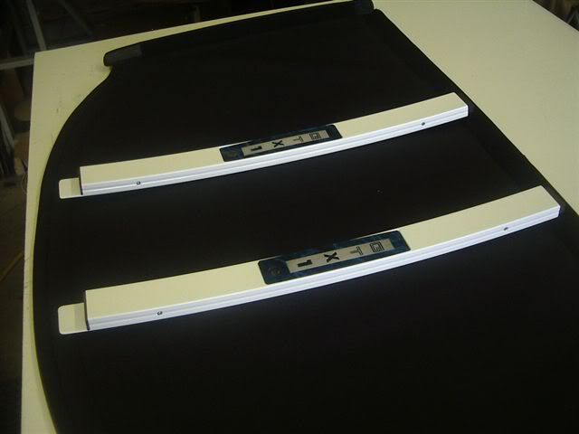

Top Bars, even though it doesn't show well these are White. I'm thinking of having the stripes carried through the other parts on the back as well, but I'll have that done out here.

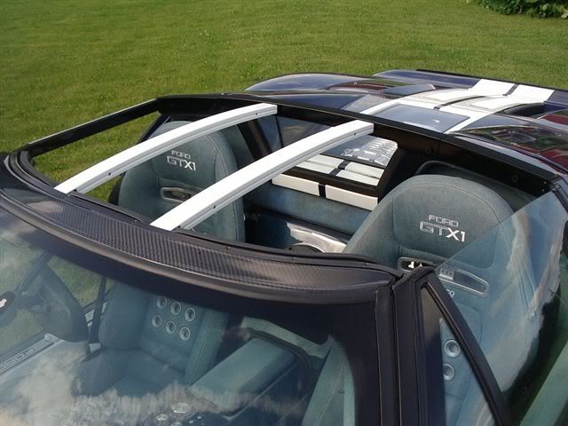

Top and side bars, the one on the drivers door is off.

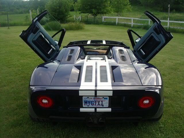

Rear View doors open

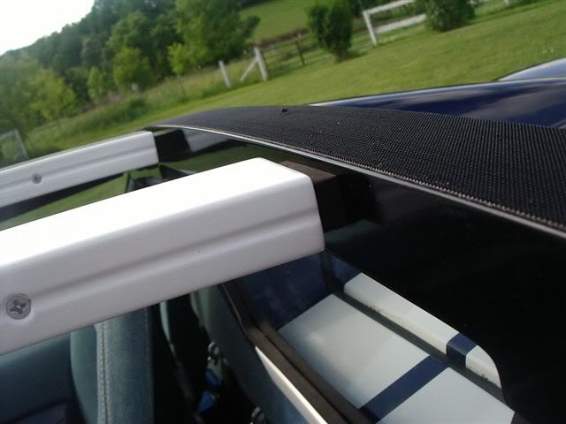

Is there any drilling required or it's just all held in place by pressure of the frame? I need this, what's the production schedule and estimated delivery if I arrange payment Mon/Tues.

Yes it requires fitting to the gal
There is a bar that is mounted within the front header and then two quick disconnect fasteners installed behind the seats.
The process is not difficult.
Production is under way as such getting your payment in will insure you a system in short order.

You guys have done so much work on this, I hate to ask for more, but I'm hesitant to do any drilling on the car. Is there any way you can post just a couple of more pics showing a closer shot of the actual attachment points? I'm sending my car up to gt guys this week and trying to collect just a little more info. A close up of the header bar and quick connect fasteners behind the seat would be a huge help.

I understand your concern however consider this;
The gal did not come with the solicited top because it was never finished however if it had been there would have been the applicable holes drilled.
In this case there are a couple small holes drilled in the front header within the trough that secures the recessed bar to which the front of the canvass slides into and then at the rear behind the headrest there is a solo hole drilled on both sides with a Riv-Nut is installed which is used to secure the rear assembly in position; an assembly that has a true glass back window.
When you remove the top the holes behind the seat are not only hidden but there is also a nice thumb screw that is inserted so that it looks nice. As for the retaining bar located in the front trough; there is no reason for it to ever be removed.
