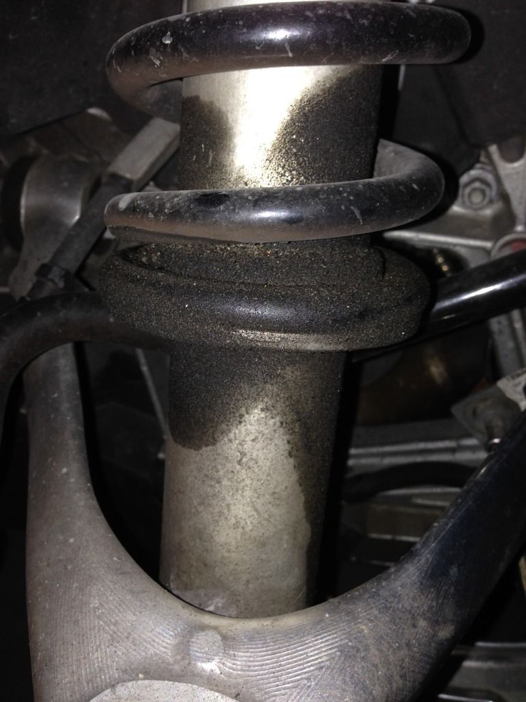

While in the process of completing some routine maintenance, I removed the rear tires and noticed an oily grime on both rear shocks.
To be honest, I haven't had the rear tires off of the car in a couple of years, so I can't say how long the oily grime has been on the shocks. Is this somewhat normal, or are my rear shocks toast? The GT has just over 12,000 miles. Any insight would be appreciated.

Unfortunately it's done. Not rebuildable. Will have to source another OEM shock or get Scott Ahlman's Ohlins!

Shock seals go bad from not being driven regularly enough. Don't let it happen again! Lol.

And some more bad news, but could be good news. My Ford dealer just had the only rear shock in the USA (in Memphis) sent to them for my one leaking shock. More than one bad I would go to Scott's set (50K miles on mine).
And Scott's are rebuild able also.
2,292
A little leakage does not necessarily mean the shock is done. You don't have to replace this right now. Keep driving it, and if it gets to the point where oil is dripping out, then it's done. You can wait and watch to see if anyone has take-off OEM shocks for sale.

True. I drove on mine for a good 7K miles after the leak was noted. But regardless, the shock will eventually fail and it is not repairable.
2,944
Shocks begin to wear out / fail in three modes... termed "weeping", "seeping " and then finally "leaking".
A certain amount of oil moving past the seal lips acts as a seal and a lubricant.
Looking at the photo, I would classify the shock as "seeping".. best I can tell from the photo.
This should not affect the performance... yet . It may not get any worse for many thousands of miles.
I would not replace until they are actually 'leaking' ... wet oil / possible drip on bottom, or until you notice a performance degradation.

Thanks. I'll take a "seeping" shock with a few more miles in it versus a "leaking" shock that needs to be replaced right now. I'll keep an eye on them while I'm saving my pennies for a set of shocks from Scott Ahlman.
