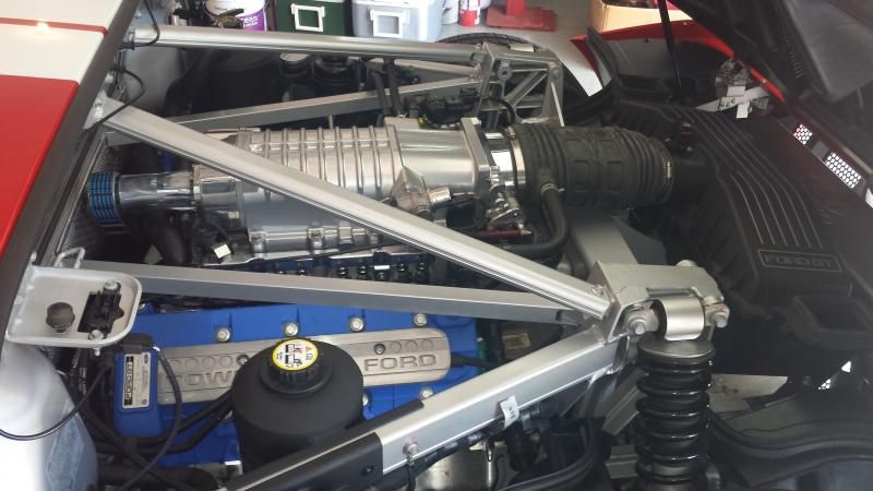

I can't tell from the photo, but the snout of the blower looks like nothing I've ever seen.
It also looks like an aftermarket throttle body. If it's an Accufab, I'd consider that a plus.

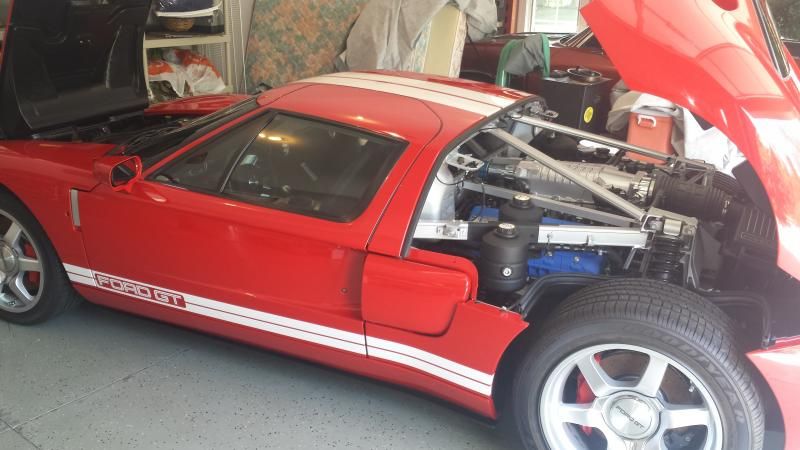

Here is a little better picture of the snout. I didnt take many pictures but I looked closely and the entire snout has been replaced. Dont know pulley size but I can confirm that.

Accufab should read its name on the part, like this:
