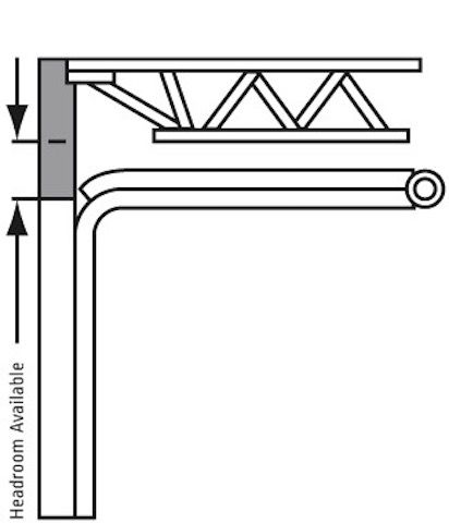

I'm getting ready to buy a lift and need to raise the height of my garage door opener. It hangs down about 25" from the ceiling and I can slam it right up to the ceiling. My question is about the garage door tracks. Is it as simple as replacing the 74" tall vertical tracks with something closer to 90"? And then moving everything up? Or is there more to it? I know they make wall mount units, but dont think I need to get that extreme.
Any input greatly appreciated
Yes

I highly recommend the Liftmaster 8500. http://store.preferreddoorservice.com/liftmaster-8500-elite-series-residential-wall-mount?utm_source=google_shopping&gclid=Cj0KEQiA_eXEBRDP8fnIlJDXxsIBEiQAAGfyoe9QBhs1OU8N1z1VLozZU920_VOTsXi5MYQTCWEg9mUaAsNZ8P8HAQ
This will place the opener motor on the wall - on either side of the garage door and gets rid of "something hanging over your car". I use these exclusively and they are GREAT openers. (FYI - you can program them for Homelink, etc. via the wall controller instead of having to get on a ladder. Also, they are VERY secure when they close. There's a solenoid that clicks and sends a locking pin into the track. Can't say enough good things about this opener.
And yes, as for the tracks, you can send the sectional door up higher and out of the way by simply repositioning the tracks assuming you have the room (height).

I have one door that has high tracks and had to add another door panel to standard number to get things to close right. That meant extra weight, and a bigger motor but it has all worked well for 10 years now.
the same as everyone else I have used the lift master for 8 years now its a good product
as for the tracks if you look there is the vertical rail and the top curved rail, all they do is just replace the straight vertical rail with a taller one and reuse the same curved rail and reposition it closer to the ceiling . the other reason for a side mount opener is that mounting the regular opener much higher on the ceiling usually affects its ability to pull the door up. I suspect that may be why GT jack had to add another panel to his door. with the side mount opener there should be none of those issues

You can do it yourself in an afternoon. Measure how much higher you want to go, saw that length out of the horizntal section and bolt it into the vertical section. Add a jackshaft Liftmaster and you're don. Little bit of tweaking/adjustment needed, but it's simple. Added benefit of Liftmaster is that it automatically engages the deadbolt once lowered.

I have 12 of these and agree, they are great. They are direct drive to the shaft that holds the springs. Just ask a door company for a high clearance door track that brings the tract within 2-3" of the ceiling.
