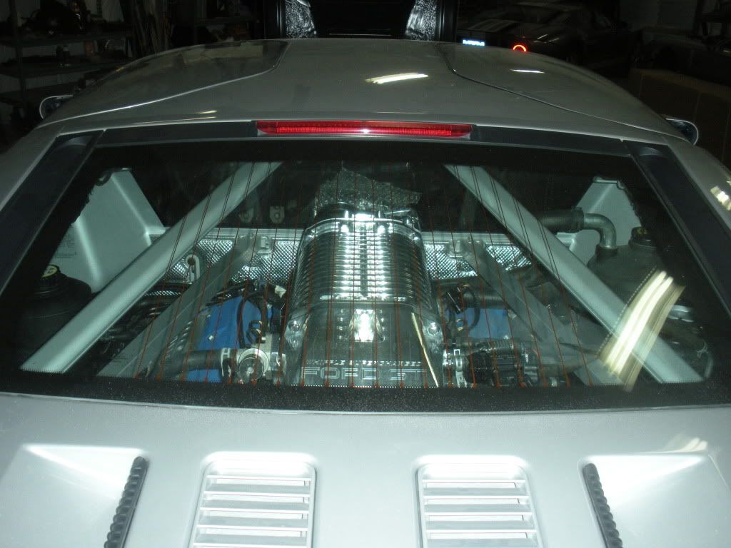

steved57
Mar 29, 2008
1,941
kilgore tx
Sounds to me like the belt was installed wrong and then they started it. Don't really see (but possible) that Whipple shipped the incorrect pulley or throttle body adaptor.
We will see how our next one goes on in about a week or so.
That must be mine huh Rich ?
Yes, I was talking about yours. Installed yesterday and no issues. The belt isn't the easiest one to install but it is on. Now off to dyno late this week or early next to see what this one pulls!!!!!!! :biggrin:biggrin
