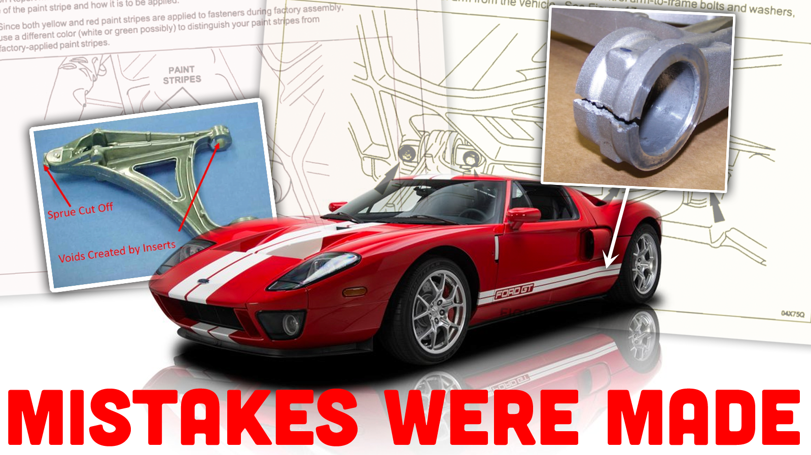

Hey Guys,
Came across this article about the control arm recall on the early GTs and it was pretty interesting. Thought I would share.

Great story by my friend Huibert. I was there .

I remember this back in the day. I agree Ford did it right and the billet arms are simply works of art visually. My 2005 has them and I still kid my son that his 2006 has the plain boring looking ones.

I remember that when the billets were acquired, they were all sent to Wixom as a distribution point before going to Roush & Multi-Matic for machining. One whole isle was filled up with pallets of approximately 2'x2'x 4" chunks of Aluminum blanks. A beautiful sight to see.

Intriguing! I knew of the issue but never head heard any of the details. The metallurgical explanation was interesting.

I remember seeing some early GTs at the dealer with "billet" machined arms. Roush did the machining of these in a timely manner. Aluminum Precision Products in Santa Ana, CA did the forgings for the balance of the production cars. It's hard to beat a good forging!

Yeah Jay, from an engineering point of view, I’d choose the forgings, but from a mechanical jewelry point of view. It’s hard to beat the appearance of the machined pieces. Maybe if they were anodized blue!
We were battling Boeing for sourcing every certified billet of 6061-T6 and then still ultra sounding and x-raying each billet before going to Roush and Multimatic. I can't recall if Wixom held these pieces before or after this testing step.
I sourced the machined upper control arms to Roush and the Lowers to Multimatic. I split them due to risk and nearing capacity limits.
