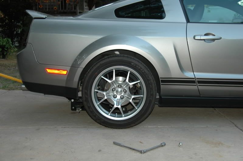

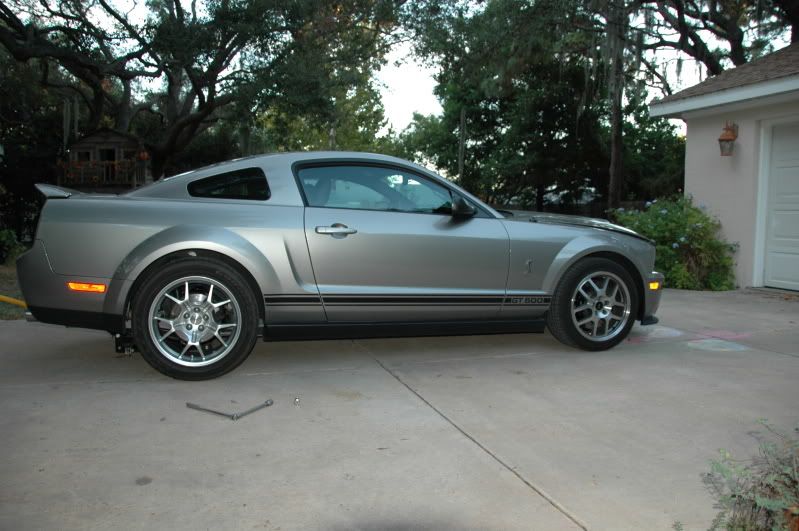

Yes. I temporarily mounted the rears on my GT500 and the results were less than stellar. Maybe its just me, but the rears make the car look like Bill the Cat.

I believe the offset is wrong on the GT wheel for a mustang.
From the rear picture shot, you can see how the GT wheel/tire stick out, looks like a good 1/2 inch.
I believe somebody here had to shorten the axle to make the GT wheel work on a mustang.
Thanks Sinovic, I always wonder how the GT wheel/tire looked.
The factory Panhard Bar holds the axle over to the passenger side. It was 3/8"+ on my car. An adjustable length Panhard bar or the watt's link will help this issue by centering the axle in the car and may enable those wheels to fit equally on both sides. The fenders have rolled edges so it doesn't require much to clear without rubbing. Another help may be a slightly narrower tire like a 305 or a 295.
