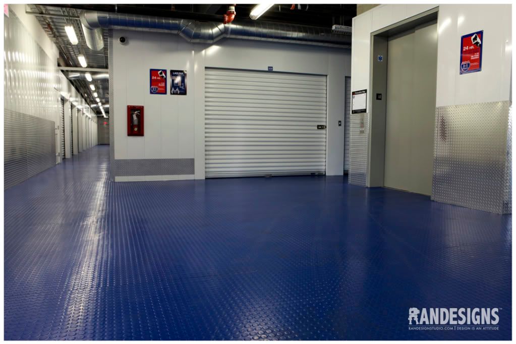

4,975
I used this rubber coin top flooring throughout the storage facility. Also installed it in one of my exterior drive up units, seems to hold up great so far.
I have that same rubber flooring installed in my Haulmark trailer. Love the stuff! Randy, that looks like an A+ set up you have there. :thumbsup
