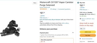

after digging thru the Ford system, I think I found the correct replacement part.
Motorcraft CX1597. I haven't tried it but it crosses back to a 2001/2002 Explorer.

Did this a couple years ago after throwing a few codes.
Here's the part I used:

Orcas, did this part replacement work? Please follow up so the rest of us know. To my eye, the part for sale only looks like half the unit needed for replacement.
You just pull your old lines off and install the new sensor. It’s also the same for f150 from the same era as the car.

They are available at Amazon just checked. 6 in stock
