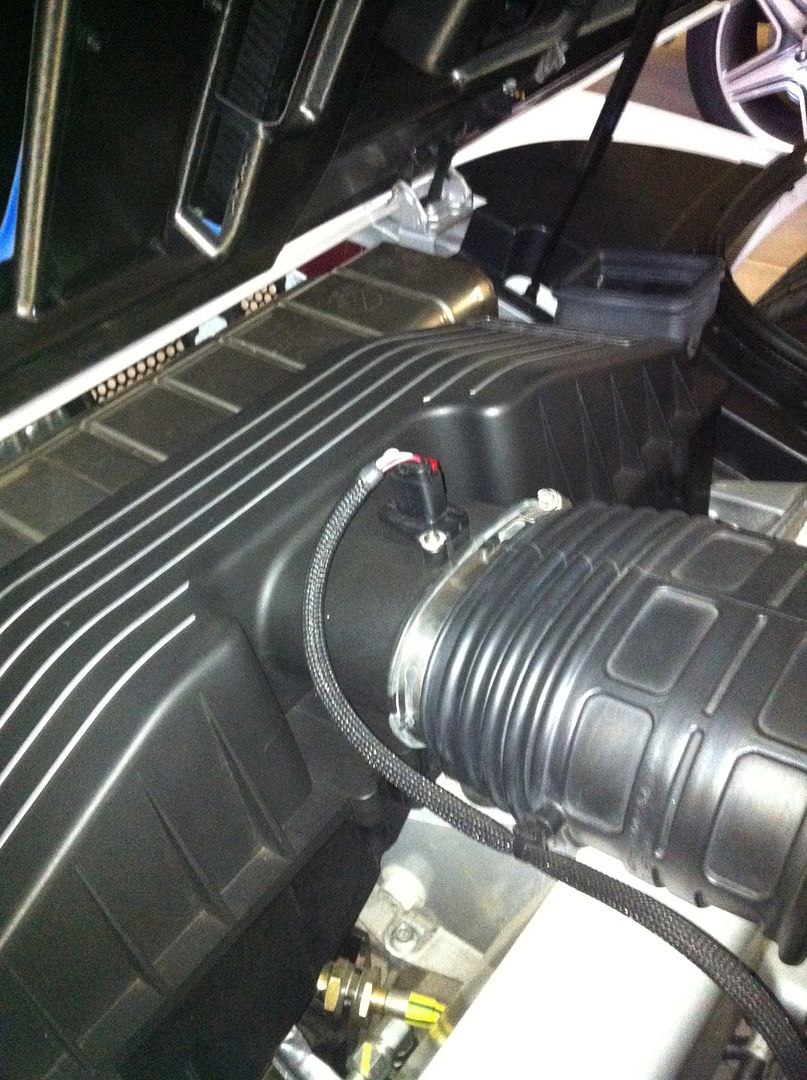

Pulling out from one of our stops and I noticed the dreaded Check Engine Light. W. T. F. ? Car is 100% mechanically bone stock. One of the 6 million reasons I DON'T want to modify the car is because of headaches like this.
When I noticed the light, the car seemed a bit sluggish. Per the dash gauge, the car would not boost over 10-11psi, vacuum 23-24 in Hg. Otherwise, car runs fine. Temps ok considering it's 100 degrees outside, oil pressure fine. I'm 60 miles from home and pussyfoot it back.
Check the codes as soon as I get home and get a p0102. MAF circuit low-input.
Did a search here and didn't come up with anything.
I would just clear it and see if it comes back, but the car doesn't seem to be running as it should.
What's my next step here?

Get a MAF specific cleaner at the auto parts store and give it a good cleaning. Take out the MAF and spray it good, but don't touch the sensor with anything but the spray cleaner.

Now for the next amateur question, what's the best way to do that? Remove electrical connector then unscrew MAF housing from inlet or access it via removal of the bellows?
Pull the red tab up to remove the connector and remove the MAF to clean it. Be gentle when you pull it out and reinstall it to avoid touching the sensor on the mounting slot. Hold it by the black connector end and spray the sensor liberally. The MAF cleaner will evaporate immediately.

Ok, got home a little early today. Pulled the MAF, cleaned the HELL out of it, and cleared the code. Then my daughter woke up from her nap. Couldn't take it out to test. Anyone know what a driving cycle consists of and how many I would need to complete before knowing if the code will come back?

Ok, about 3 weeks later, I finally got to take the car out for a bit this evening. 1st through 5 gears, up to 6K rpms a couple of times. All seemed fine. I stopped by to fill up the tank on the way home. Pulled out of the station and the CEL popped up again:mad
Same code.
What's my next step?
