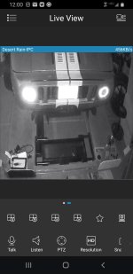

I've got the HD9XW. The extra length and width I thought might be a little much, but I'm glad I did it.
Sorry bout the image, but you get the idea.
