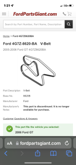

So now I need a newbie belt but no longer a ford supplied product.
BMF or nota4re... got this part?

4,199
Belts are readily available. Ford GT Belts
Reactions: extrap
Thanks a ton
You've smacked that one out of the park for me
Any preference on brand/model/size?
I don’t have a part number on me to check for compliance
