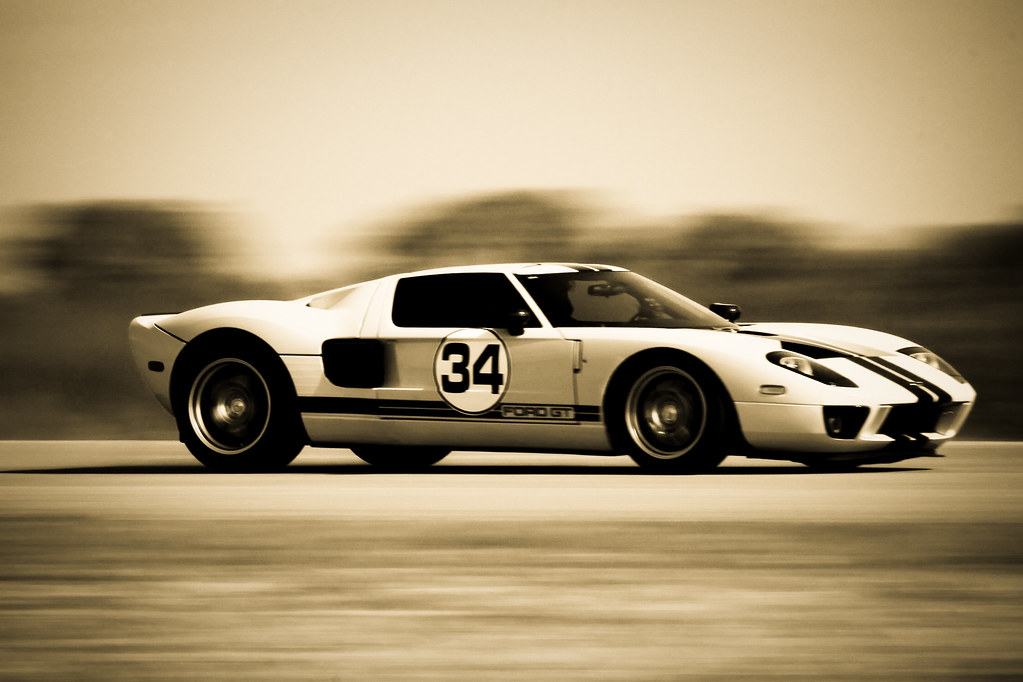

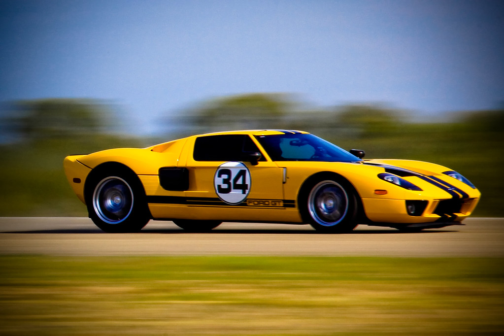

Awesome shots. I love how you can see the aero working on the GT's. In most of the pics you can see how the front splitters are pushing down on the outboard sides from all of the downforce. You can also see how the front is pushing down on all of the cars except for the open clamshell one. Quite a bit of front end lift on that one because of the unintentional "parachute".
Just as a side note, if I remember correctly, on a totally stock (suspension) car the suspension should be just about bottomed out at 205mph. That was design intent.
Also on the open clamshell this is why there were 2 hooks, just in case. One would have flexed the clamshell and let it fly off. It happened in the wind tunnel once. Nothing but pieces afterwards.

Hey Ray,
As you will almost certainly make history at your next event, let's be photo ready. I would like the honor of tapeing your car to protect it from rocks before you run. In the photos below the entire rocker panel, wheel well edges, scoop leading edges, and the panel below & behind my side scoops are taped. I used black tape to recreate the side stripes behind the doors. A smooth surface has less drag but more important, it looks better in the pictures!! :lol Your tape looks like it was done at a UPS shipping dock. :biggrin
I am still on a high, I had so much fun with you and your crew last weekend. I can't wait for the next event. :banana :banana :banana

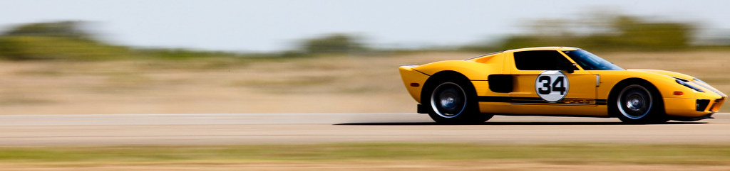

Does that mean those that running significantly faster than 205 should up the rate rates on the suspension, or risk bottoming out? My understanding is having zero suspension compliance is a bad thing, but maybe on a "smooth" runway maybe not a big issue.
at 226 I did not "bottom out" and if I did I could not tell.
Just look for scape marks under the front end after the fact. I would agree that at 226 it would be very hard to hear it.

Slight improvement.
Needs just a bit more space in front of the car. What do you think?

Chip, if that was during braking you are fine, could lower it a bit. If still accelerating and at 220, then I would think the front end might scrape under hard braking.
Awesome photo!

Ice,
Even with the shocks bottomed out, the front splitter would still be a couple inches from the ground. It would not scrape. Ray and I are both using Penski coilovers with spring rates much higher than stock. Even those stiffer springs were compressed the majority of their travel at the mile mark. It's a trade off adjusting them to avoid a nose up attitude while accelerating in the first half of the run and scooping air under the car, but still having some travel left near the end of the run as the nose is forced down by aero force.
The Penski shocks are adjustable for spring rate, pre-load, travel, and have seperate adjustments for compression and rebound dampening so differen't combos can be tried. The stock shocks would have the car more nose high at the start and more nose low at the finish.
I like it the other way.....as if you're about to run right off the damn page...or the camera just couldn't keep up. A real sense of speed there.
